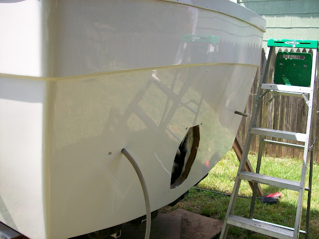

I am still in the process of rebuilding boat after painting it with INTERLUX PERFECTION. My best success was by not tipping and using a foam roller from Lowes. I could not get the brush strokes to flow out. I tried tipping with high dollar brushes and foam brushes. Rolling only worked out best. I used their thinner at about 10%. Sometimes a little more. Cool temps, no wind, and out of the sun are a must. These conditions gave more time for the paint to flow out. Perfection is a great product but not easy to work with. Practice rolling, only a thin coat. See if results are satisfactory.
Mark
More pics.....http://picasaweb.google.com/kelmarray
