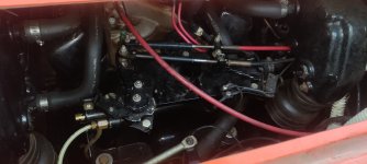

ratdude747
Sep 30, 2023
425
It ratchets both directions in both FWD and rev. Definitely needs checked. 😬
