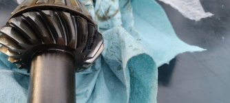

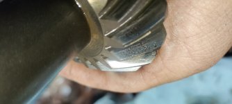

The gears have some very light pitting:
Nothing massive... But still ok to use? The bearings feel great... Smooth as silk.

You think my gears are still worth using? I don't recall a lot of gear noise... but the pitting is concerning. If it was just one pit (or a few in one spot), I'd think nothing of it (the cam in my truck was like that when I rebuilt said engine... still going strong). But several teeth on both gears have a lot of shallow pitting.
alldodge
Mar 8, 2009
43,956
I don't see enough pitting on the gear posted to give me major concern with the motor you have. If there is worst spots then could be and I'm not there look and feel
I showed the worst... but it's like that on several teeth on each gear. If I just need to replace bearings and knock that stubborn seal, then sure.

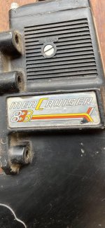

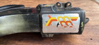

Got it. Not as good cosmetically (lower unit has corrosion) under the paint) but no leaking u joint. Plan will be to swap my lower over... Maybe reseal the upper since I have the parts?
Obviously I'll have to keep the case and gears together since I don't have a shim kit...
Edit: maybe I want to just salvage gears and yoke after all. Upper case is pretty chewed up. See second pic. Maybe between both I'll have enough shims to be able to make things right. I do have a test indicator that I used for setting backlash on my truck's rear end earlier this year...

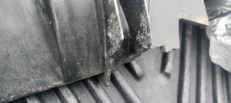

Bad news is the u joints are bad and the upper case damage is worse than I thought:
Both sides are cracked. There also is corrosion in the bell housing gasket area.
Making a case and joint swap with the old drive tempting but not sure if worth the trouble of having to check shimming. But replacement cases are a thing they sell, so it's justified on at least some cases?

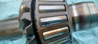

Didn't spin smooth. Like at all.
Now what? Reuse my old gears and use new bearings? Or fetch the other drive I found this coming weekend?

Edit: attached is a better picture of the worst gear tooth in the old gears.

Your old motor is not a HP big boy so using your old gears does not concern me, but this is your money and not mine
I would rebuild the one you have, but do check how much the special tools will cost. I spent over 700 just to do the lower on my B3 drive, and did that because there was no one around I could trust to do it correctly

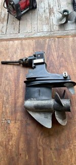

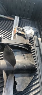

We'll see if I can get a day off... The drive does legit look better than this one. I've attached the pictures from the listing. No corrosion, just lost paint. And the U joints look very clean. 3rd time's the charm?

Got the drive home.
A mix of good and bad news.
First, I drained the oil... looking really nice:
At the end a bit of moisture, but hardly anything:
Tearing the drive down had some issues... first, bozo here hit the wrong spot with the mallet and broke the lower:
The shifting was very sticky, so this lower wasn't worth much at least. I also noticed that fully assembled I was able to turn the yoke without much impeller resistance (I was just checking for backlash, and it spun over!) Once I got it off, that mystery was solved as apparently the impeller blew up hard:
(look at the water guide tube... wasted!)
The upper spun nice and smooth. But, in the interest of verification, I popped off the top cover... and broke the bolts:
Whoops... I know a couple of machine shops so if this case gets used (see below) I could have those professionally drilled and helicoiled (not feeling lucky with vice grips and a torch!). I will also note that the trim cylinder pin is stuck in the case and the threads have a bad spot (nothing terrible, but the pins off the other two drives are in better shape.
On the plus side, the bearings and gears, while not mint, don't look terrible either. Some staining, but no pitting like I have in the other two drives.
Am I correct that to avoid needing to shim, it would be worth the $ to have this case repaired? Or am I better off to move the guts to the first case and somehow confirm/correct the shimming to fit the new case?
Edit- doing some reading... I do have a flux core welder at home. Not sure if it's good enough for welding nuts to studs here. I do have MIG access at work and via my Father-in-law. But I've also seen too many cases of people attempting a DIY extraction and ruining things.
