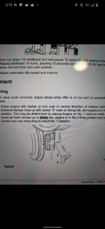

Was able to get out with my digital timing light to check advance. I have base timing set at 1BTDC according to this timing tab. At 2600 RPM with my timing gun set to 23 degrees, the timing mark was showing around 8BTDC . When I turned my timing gun to 28 degrees , the timing mark was about on the 1BTDC mark. Does this mean it is over advancing? The manual states I should be around 23 degrees total advance at 2400-2800 RPMScreenshot_20220510-181339.png

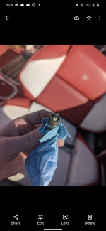

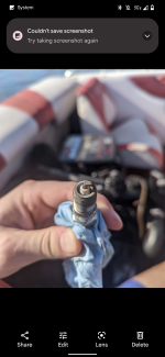

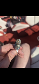

A few plug pics after a high throttle / WOT run. I still hear some chatter / rattle at higher RPMs. Not sure if it really is knock or not

alldodge
Mar 8, 2009
42,633
Don't see a 1 BTDC mark but would agree your about 23 degrees advance
Need more time on the plugs to determine if its actually lean. Correct if I'm wrong but the plugs have very few hours on them

Okay, so timing is good. And yes the plugs have about an hour or two total on them. They're practically brand new. Think it's safe to just run the boat for a bit now? I will add that on the first acceleration of the day out of no wake, it will bog under immediate throttle. If you ease into throttle it's fine, and after that punching the throttle doesn't cause any bog.
Edit: I can't visibily see the marks on my timing tab eve after some sanding. I just found the diagram in the manual that looks closest to my tab (same # of points and valleys) and went based off that

I would suggest making the carb run richer. Increase jet size or get a larger carb. A motor won't be destroyed if it runs rich and can be leaned out later
A take off bog can be lack of fuel
Don't run it hard, maybe keep it just enough to cruse and give it time and recheck plugs
You need to use a piston stop and verify that the TDC mark you are using is actually TDC.

The plugs look good in the latest pics, appear to have a good color with even burn across the porcelain and tang
