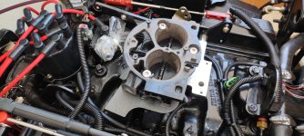

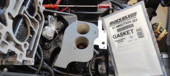

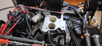

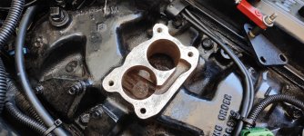

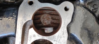

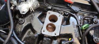

Chris,
Did as you suggested and then reassembled...

Oil's colour seemed fine, the smell though... Is it possible to have a scent of petrol?

it is possible to have gas (petrol) in the oil if fuel injectors are leaky and don't shut off when they should...
the codes, I'll let others famaliar with this system comment on....

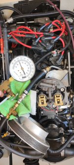

alldodge,
Connected the fuel pressure gauge, turned the ignition key and the gauge wrote 55 for one or two seconds and the stalled at 30. So I guess the pump and regulator are fine.

Pumps good but can't say the same for the Reg. The pump should be capable of producing 60 psi and with the gauge going to 55 it does.
The Reg should keep fuel pressure at 30 which its not doing that. It does bleed down, but it should never get above 30 in the first place. Remove the Reg and see if the screen under it is clogged

The gauge's pressure was indeed bleeding down slowly, but I think it was due to the banjos I used to connect the fuel hose. I used a towel and got wet with fuel right where the connection was.
I didn't know that the pressure should at no times reach more than 30psi, I guess the next thing to check is the regulator....
