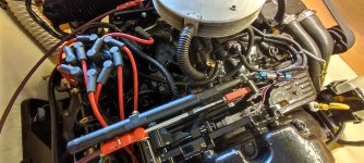

A better pic of the intake with the wiring harness not covering the bolts would also help..

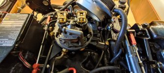

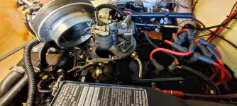

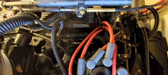

Took some pictures...
alldodge
Mar 8, 2009
43,019
Looks like 4 bots on each side of intake, and if so that's a vortec

It’s a pre Vortec for sure like I thought. First the Vortec bolts go straight down not at a angle and second I see one of the extra bolts near where the choke stove would have been if it had the Quadrajet.
You can see the tin cover that covers the choke stove opening with a bolt in it and below that is one of the extra bolts the pre Vortec had. Vortec has no exhaust crossover at all therefore no choke stove. So Vortec engines with carbs had to use electric chokes.
With the pre Vortec the 4 front & rear bolts all go in at an angle and the center 4 may appear to be at a more shallow angle or almost straight up & down. On my V6 those were tough to get a torque wrench on!
Still could have a roller cam though because the roller cam came in 87/88 and Vortec heads in 1996.

Are you sure Lou? Blow the below pic up, notice the first intake bolt. The intake bore is filled flat. There are two pics, look closely. That would be a vortec intake

The one on the right is for sure a Vortec as you said; what makes me think the OP’s is a pre Vortec is the tin cover for the choke stove. Nothing like that on a Vortec. We ate like forensic detectives trying to figure this out lol!

Number 2 intake runner, notice the bolt and the bore...the bore hole is milled flat.

I’m still seeing it at an angle like my old pre Vortec…
I think that given the difficulty in finding the correct ECM a carb engine would be easier. The OP might have to find a shop that caters to American classic & muscle cars to get a marine carb set up right. Seeing as how it’s a Merc an Edelbrock 1409 would be easiest due to the ability to find the right brackets etc because Merc used the very similar Weber 4bbl.

To the OP simply lift the wiring harnesses and count the # of bolts holding down the intake on both sides. I think you will find 6 on each side. This answers the question of Vortec vs Pre Vortec but the issue of flat tappet vs roller cam can only be answered by the block casting #, or removing the intake and looking lol!
For the question of tuning Vortec vs Pre Vortec matters but I’m not sure that flat tappet vs roller cam does.

That tin cover over the choke stove area and the few bolts I could see are angled not straight up & down says to me it’s pre Vortec for sure.

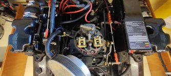

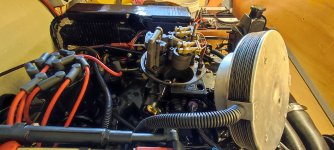

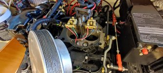

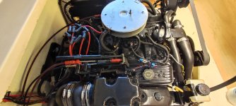

Chris,
Thank you for your answer.
So what would you do if you were in my shoes?
Had the ecm shipped to mefiburn for inspection? Does he has to know whether it's a flat or roller cam for programming it?
Something else?
Kind regards,
Kostas

Chris,
I'd be verifying everything else before an ECM fail conclusion.
Check with MEFIBurn and see if they offer that service.
I would include as much information as possible. I would pull the distributor and use a borescope and have a look at the lifters, see if they have a flat base or a roller.
Something else?
I think, at this stage I would be opting for someone with more electronics knowledge than a mechanic. Someone who understand the granular detail of fuel injection. Most traditional mechanics only have a limited knowledge of the finer details of EFI. Personaly, I would be examining all the sensors inputs and ECM outputs with a multi-channel oscilliscope. It's unusual for an ECM to fail in the way your describe, so I'd be ruling out everything else first.
