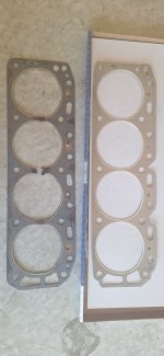

Note the old gasket is a FelPro. I don't know that Mercruiser used those OEM, so that's likely a replacement. Might want to look up the part number just for kicks to see if that's a marine set - not that if it isn't this would be the cause for that blowout. For sure the other spot was on it's way out.

I've noticed that as well and I'm not sure if that's OEM or not... However I just got in the new gasket kit and I have som questions and posibble concerns... I took a side by side picture, and I've also placed the head gasket on the block. There are 4 small(circled in RED), they seem pretty small on the gasket compared to the block and my old head gasket... Also the big water port in the back(also circled RED), the gasket sort of goes a little over the port. Is that okay/normal?
Also is the dimensions in between the cylinders on the gasket okay? They aren't too thin/small? The material is also different, the Fel-Pro feels more like "metal" lol, but this one feels softer and sort of rubbery. Maybe that's normal? I'm sure it won't blow out on me...
Other than that, everything seems to line up good.

There will be no issue with the differences. Looking at the old gasket, every spot between cylinders were bad. I think you'd be well right to have the head milled and verify correct timing upon reassembly. That's what we call down in these parts, "Blowed up big time!"
