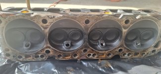

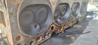

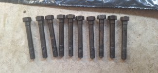

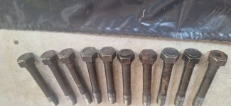

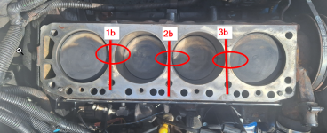

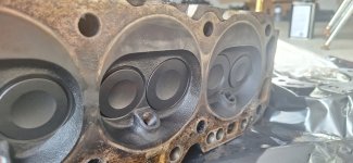

If the head cracked - due to improper tightening sequence even when there is a gasket that is compressing - then it would have surely failed while in service. A huge thick hunk of cast iron is much more resilient than you might think. The gasket will have already been compressed, so there will be no issue. But if you feel more comfortable following a sequence, then there's no reason not to do so.

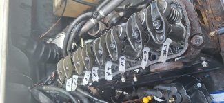

As far as the lifter preload, I'm referring to the valve lash (zero lash plus the 1/2 turn or so preload). What you do when setting the lash is actually put a preload on the lifters which pushes the adjusting piston down into the lifter against spring pressure. It is imperative that this is done on the base circle of the camshaft where the lobes are not lifting the lifters. The best way to ensure this is that the cylinder be at or around top dead center on the compression/power stroke. Looking at where the rotor is pointing and working on only that cylinder is a great wat to ensure this.
