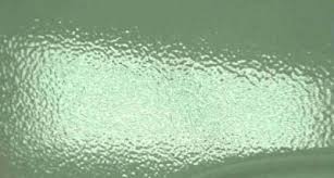

This shows what Orange Peel in a paint job looks like...

If you're gettin fisheyes, drain the compressor and let it run with the valves open for 5 minutes. Change your filters. Make sure and wipe down with Acetone before shooting. FE is caused by contaminants.
