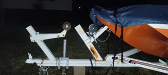

The crux of the issue is that this trailer was likely designed for a 17ft minimum length... but this trailer happens to be what the marina had to trade for the original trailer that also fit the needs of the original owner.
Just because the current setup worked for 48 years doesn't necessarily make it right or in any case make it ideal. But, it's possible to rework the trailer to better handle my 16' hull without having to replace the whole thing, so when such a replacement turned into a boondoggle, reworking the trailer is the direction I'm opting to go.
The winch stand literally cannot move further back... it's at the limit of it's travel:
Likewise, the entire fender/leaf spring/axle assembly is attached to the frame with U-bolts (fully adjustable). So, however far I move the boat, I can also move the assembly to keep the tongue weight consistent. Ditto for the front keel roller.
One of my concerns is that the bunks are seeing excessive load due to the transom being past the rearmost bunk supports. Also, any bit I can move the boat backwards is less deep I need to back the trailer to launch. Hasn't been an issue other than the one bunk rotting to pieces last season due to pitot tube damage from the excessive bunk stickout. Still don't like it.
So, the plan is to install the new winch stand (see below) so the current position is maintained (with gap between the stand and the upper tube end); once the boat is on the water on a future outing, I'll move the stand and axle assemblies on shore (no boat weight). Ideally 9", which puts the transom just past the end of the inner bunks (and a bit further past the outer bunks) and with the transom straps at the correct angle (pulling the boat into the bow roller, not away from it as is current).

Yes, with a bigger/newer truck with better brakes, trailer brakes wouldn't be warranted... but, since I already have flanges for brakes on the current axle and my truck already has a good brake controller and a fully wired 7-way connection, I see not adding such brakes as a relatively low hanging fruit, and a lot less expense than changing trucks.
I don't know what the GVW of the boat and trailer actually is... the max GVW of the trailer is just over 3000lb (IIRC around 2600lb max boat/gear weight per the trailer tag). As for the boat itself, JD power says 1500lb, but I don't know which engine option that's for (I have a mercruiser 888 302, the heaviest option offered- the engine alone is reportedly 460lb per Ford). Some jurisdictions (Ohio, for example) require brakes on 3000lb... while the limit in Indiana is 3500lb, I figure it can't hurt and several people I know personally agreed that brakes wouldn't be a terrible idea.
I'll be driving up Friday to look at the boat winch/stand in my last post. I was able to get some more information on it... the orange junk in the pic is dirt from sitting in a gravel lot behind the guy's shop. Certainly looks beefy enough (beefier than the new option I posted previously). And the measurements do check out (should be able to get the full 9" I want). Yes, it is used. But I already have a virtually new winch to swap (that nasty old winch is going to the scrap pile)... and if the structural steel is solid (not rotted out) and not mangled, then good as new for my purposes.

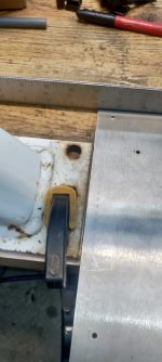

Did some work in my Father-in-law's shop this morning (they live on the way home in Lafayette, IN, so we turned this adventure into a visit with them)... pulled the rusty winch and mangled U-bolt off. I then moved the winch mount to the 23.675" measurement I previously measured:
Now, to measure the roller offset:
My measurements in Post #2 did not include the base flange, so assuming they're the same (they look to be close), we're at 7.5" back.
Put that in CAD against the existing setup (again, Post #2 reference) and:
Just a shade over 9". Poifect!

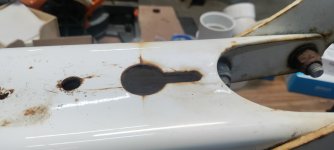

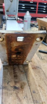

I did notice the end cap of the stand post had a crack.. popped it off:
Some flakey stuff at the bottom from the flange, but the inside is just surface rust. Nothing condemning... and way better than what I currently have. As for the other side of the baseplate:
Yeah, about what you'd expect. There is a factory hole.... but clamped to to a tongue, probably won't drain much. I'll be curious to see if my existing tube has such a hole (heck, I haven't even pulled the end cap to see what's in there :oops:.

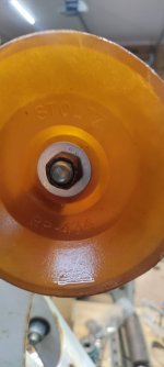

Finally, the rollers:
From what I'm seeing, a $75 set new. A bit of wear but nothing terrible... way better than the warped hunk of rubber I currently have!
Seems we do have a winner?

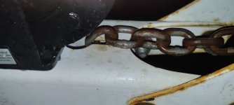

The last post is incomplete. I had my best friend show up (the one whose aunt gave me the boat!) and had to finish the post... and in doing so, I forgot a picture.

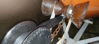

It seems that they did give a turnbuckle/chain point on the winch mount:
I'm wondering if this is to allow a chain like I added to my current winch mount to be used, but then one pulls the chain tight through the keyhole slot to take up the slack. Similar to how narrow chain hooks work; I've seen flatbed tow trucks use this trick for rear axle chains.

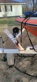

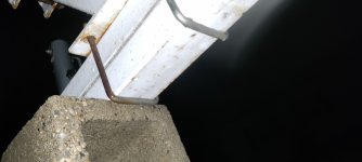

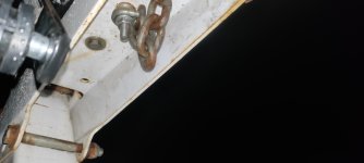

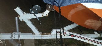

Made it home... and while it was approaching midnight and drizzling... I had to install it! (Well, mostly, see below for the caveat).
Originally, I was just going to mock it up. I already had a loose U bolt (that I discovered and didn't bother tightening up) and did this to confirm all the measurements worked out:
But, then I figured "All I need is a 9/16" deep socket and I can swap everything really quickly", so I did:

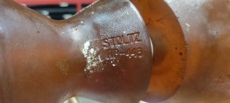

Stoltz rollers fit great:
As it turns out, yes I can use the keyhole with my chain with the winch installed:
Sure, not zero slack like a turnbuckle, but far less than a mere loose chain. Idea being one can lift/push the chain from underneath to feed a link or two forward to be able to remove the chain, but if it pulls, the slot catches the link underneath. The bolt connection is merely retention for the loose end and to ensure it's never lost when the boat is off the trailer. Edit: apparently keyholes like this (not just T-holes like I'm used to on tow trucks) are common on utility and dump trailers for safety chains... just never seen this on a boat trailer!
As for how much room did I gain to move the boat back... current measurement is 7 1/4. Obviously there's some errors in original estimations, but that's still a good number (leaves 2" of exposed bunk at the end, which is A-OK and way better than what I have now).

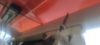

As for the caveat, I think the U-bolts I reused are too small (3/8", should be 1/2"):
The post doesn't self-center due to slop. It's currently a bit crooked. To be fair, the mangled U-bolt that I pulled from it this morning was also 3/8"... but I think I can do better and will see about ordering 1/2" U bolts. Edit: Seems nobody makes a 3" x 5.5" U bolt in 1/2"... so maybe this is right and I just need to straighten things out?
All said, first big step mostly complete?

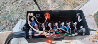

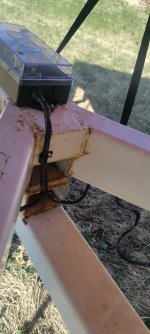

7-way cable/junction boxes were on super sale the other day, so I ordered one... and it came in. So, I decided to install it:
Seeing this (and how terrible my old install of the the marker lights was got me thinking... could the lights be part of the box. Well, a couple of 5/8" holes with a step bit and a firm shove later:
No, I didn't seal them, but they are a very tight fit... cannot spin by hand. About as well sealed as the rest of the box is by default... this part doesn't get submerged, so I think I'll be fine. Yes, I had the "top" marking on both lights pointed straight up.
As for the ugly holes where the marker lights used to be, one side likely will be where the breakaway battery will go. The other, I don't know... but that's a cosmetic issue more than anything.
Obviously I don't have brakes yet... but this is to allow for that in the near future. One thing to be aware of if one buys one of these cable&box kits is that they often use the "RV" standard, not the SAE "traditional" standard for wire colors:
The dead giveaway is the colors used... I confirmed with a multimeter that the cable pinout is correct (which for the RV standard, it is). Thankfully, the only difference is the light controls, so everything should match up when I add brakes.
Here's everything lit up with a truck test:
I still need to tie the wiring up externally. But otherwise, another portion of the project done?

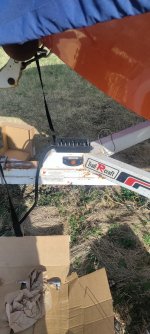

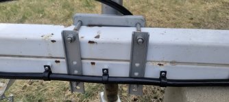

Tied up the wiring better:
(Also got the reflectors installed... easy and cheap fix)
The main cable will be locked in place with a zip tie or two once I have the truck hooked up to it next so I can get the length dialed in. A lot of this intentionally "loose" due to all the changes yet to come.

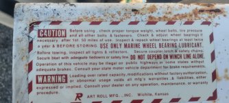

Another thing of note... took a closer look at the warning sticker on the failed winch post:
(Not sure there's a good way to salvage and re-adhere this... Not that anybody cares about such a restoration on a boat trailer!)
Interestingly, there is a note about brakes... probably referring to 2000lb states. That partially explains the presence of brake flanges (although, it could also have been a common axle also used on tandem 7000lb trailers).

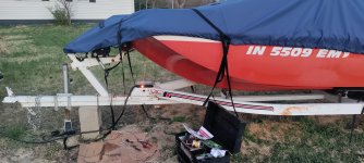

Came home from lunch to find my wiring being inspected:IMG_20250413_132633.jpg
The inspector says I'm nuts. Well. He has a point... Ok, you can stop booing now!
Anyway, I wasn't happy with the section by the jack mount, so I redid it:
I'll probably replace the spacers as white nylon and UV don't mix. But it's what Lowe's had stocked...
The part by the winch stand rubs the u-bolt but that'll resolve when I move the stand the next time the boat is off the trailer (unless I find a way to get the weight off the bunks while on land... No good ideas). And due to how the stand fits, any bow steps added will need to be the kind that mounts to the winch stand, not the tongue (as they can't be in the same place on the tongue). Thus, I only need spacers on the part by the jack mount.
One other note: moving the axle back 7" will put it directly under a crossmember. But, I have 3.25" clearance under load, so no worries... Any further back and I'll hit the bunk studs!

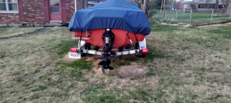

Oh boy... this will be a long one. Got the trailer brake system installed last night; been working on it since Saturday when parts started trickling in.
First, the night before last I got the breakaway box and all remote wiring installed:
Breakaway box has a solar cell on it to top off the battery. Something I trying out.
Yesterday the brake units (and other wheel/bearing hardware) came in, allowing the install to be completed.
Apparently one of the studs was never seated right in the old hub:
Brake unit installed:
(this jack setup is a bit sketchy, but everything else I tried with the trailer on grass was way sketchier! I didn't bother with jackstands due to not working directly underneath the trailer while it was on the jack)

As for the wire routing, here is what I settled on:
Other than the wire clip screws, I didn't drill any extra holes. I used the existing lighting wire route and then turned it back to the axle. This way when I move the axle in the near future (winch post relocation project) the wire length won't become a restriction.
After that, I hooked up my truck to verify all is working and to get the 7 way cable length settled:
Everything seems to fit together nicely. Other than the breakaway battery being very dead (too low for the solar to be of use, everything that I could test worked great. And the battery took enough of a charge in an hour or so of being plugged in that at least the charge tester is actually responding... hopefully the solar starts charging it the rest of the way.
I am sore... apparently this job was more intensive than I remembered! But it's finally done...
