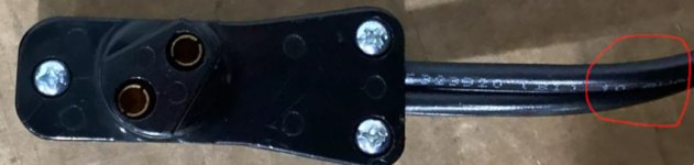

Edit- found a used 712/912 on eBay that had the stock 40' harness with it (Wholesale Marine of all sellers, go figure)... that harness is clearly 10 gauge:
And it is a "60A" Harness... has two 30A breakers in parallel:
So for "30A", 12 gauge is probably fine, just swap the 20A fuse for a 30A breaker?

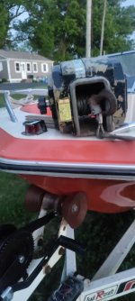

Winch was delivered to my boat...

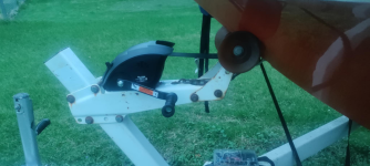

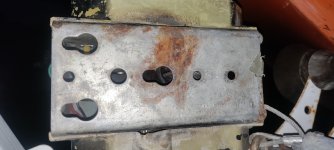

It does fit on the winch mount (and still allow the safety chain to work)... but no holes line up:

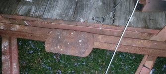

If I drilled new holes, one option would be to use the mouse ears in the winch so I could remove it and use it on my car hauler:
(My Father-in-law, the previous owner, fabricated that mount to use with a harbor freight winch; the bolt heads don't clear but the pattern is right).
Is redrilling a winch mount like that OK to do? Or is that going to weaken things too much?

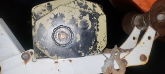

Electrically, the switch is sticky (isn't fully momentary) and looks to have been cobbled (original switch is a rotary, not this janky feeling paddle switch). The power socket is also a bit worn (cover snapped off). May end up redoing both; the parts are available but pricey. It's a pretty standard connector hole and mount screw size though, so I could do something a bit more generic and make my own harnesses (if using the mouse ears, then I'd have harnesses on both trailers, allowing the winch to be used on either as needed)
Mechanically, the "emergency handle" is a standard boat winch setup... but for testing I was able to use a 3/4 wrench (and later, socket on a cordless drill). They also had the cable spooled backwards (underhand, not overhand)... fixed that. It doesn't free spin well, but the gears aren't well greased (but they didn't look chewed up at least). The cable has seen better days (a few filaments frayed about 2" from the hooks), but those are still made it seems. Edit: Not so sure, since Powerwinch doesn't make a 1500lb winch any more it seems. Generic cable/wire rope can be bought in that size and rating more than likely, but if going there, I might be just as well off to chop and recrimp a new hook since the fault is right at the end. I'll need cable crimping tools anyway... I dunno. Edit #2: Seems that various placed have a 20' 1500lb Powerwinch cable (Powerwinch P7188500AJ)... so they are still available if not still made (many places show it as discontinued). If I end up using this winch, I'll probably just grab that and call it good.
