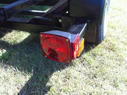

3 - Trailer (wheel bearings, tire inspection, lights-I noticed a tailight lens missing.)
I fixed the taillights already... dont really want to be pulled over on my way lol

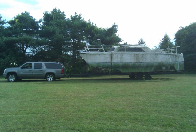

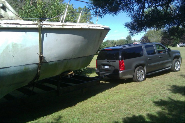

On another side note... my brother just picked this behemoth up yesterday... its going to be his winter project :D

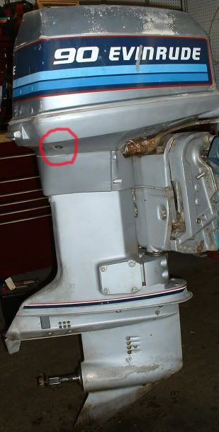

I was just speculating b/c I recall first seeing one on a 1988 when it was new but not on previous motors we had at the time. Since then I've acquired old motors but never paid attention to years with or without. Come to think about it, I think a 72 merc 20 has one, not sure. And I suppose they could be added.
To the OP: lots of motors don't pee at first, or at all, on muffs. look for a tube running from the engine block to the bottom rear of the engine housing. Also on old motors, they get clogged with mildew or even (as I recently experienced) disconnected, spraying the inside of the motor!

Exhaust pressure relief holes so the motor will run when the boat is not moving or moving slowly and the prop exhaust is at it's deepest point which creates back-pressure. Good luck!
