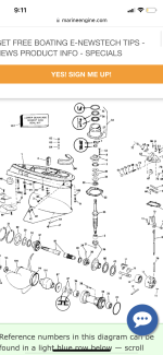

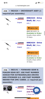

Here are photos of the diagram and drive shaft and bearing parts. 35&36.

The parts diagram lists the forward gear, reverse gear and pinion gear.
I’m guessing the pinion gear is on the lower driveshaft.
Maybe the forward and reverse gears are ok because the prop still rotates in either direction when put into to gear and the drive shaft has all the play and is the shaft that spins oddly?
The shifter dog clutch is also listed, but if that was bad, it wouldn’t go into gear right?
I am going to try to remove the lower drive internal parts tomorrow, but just trying to gather a list of parts I’ll need.

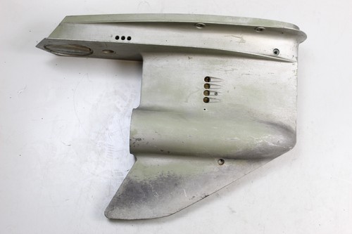

Here’s a complete unit.
Says for use in stringer models with 800 v6 or v8.
Some small differences and I’m not sure if mine is an 800.
