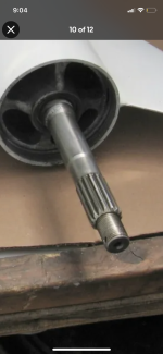

I just looked at my prop.
The markings on it say 13 3/4 X 15.
So it is a 15 pitch propeller?
My prop shaft has 13 splines.
My 1984 manual looks the same as the 1985 book Redrig posted.
I did also notice that the lower drive ratio for all. 3.8l, 5.0l, 5.7 is 14:26.

39,521
Count the splines again.-----Count the splines again.----I am convinced you have a 400 model lower unit.----13 splines and a coarse thread on the prop shaft !!!!!----Post #21

Here is my prop shaft.
I will re count the splines again.
I corrected a mistake I made earlier, I counted 13 splines, not 14, but will double check.
First 2 are mine, second one is the one on the eBay unit.

Yeah @racerone nailed it.
I wonder of your upper unit is from a 400 as well. I would confirm exactly what you are working with before proceeding.
Someone has swapped things out and didn't match it up properly.
(Did they swap the whole drive or just the lower unit ????)
