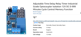

this little gizmo could ground the tan wire for a few seconds on longer(choose) at key on to confirm the warning buzzer works.. of course if the engine sensor goes South on its own ...then you may end up the creek ...
Basicallya beeper timer like ETEC tach beeps at start up :)

Actually I was thinking about using this, but I'm not sure if the sensor leads can be extended.
The black and yellow wire are energized if the temperature is out of range. I can hook that up to the existing siren, and as an added bonus you can monitor the exact operating temperature.

one of these is even simpler ..one side to ground & one side on TAN and bolt it up ona flat spot or use heat paste used in electronic board for heat sinking.
