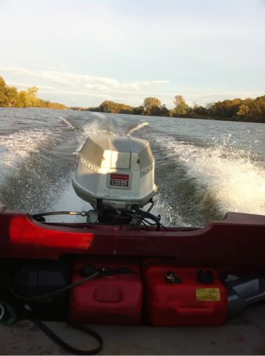

I have 2 6 gallon gas tanks for my boat, and only 1 hose. is there any sort of y splitter connection so i can have both tanks connected and easily switch to one when the other goes empty?

last time one went empty, im in the middle of cruising full speed. The boat stops i have to jump up and go to the back, switch the tanks positions (cause the hose isnt long enough) all while the boat is just floating down the river. It be much easier if i just had a switch that my passenger could flip that would select 1 tank or the other...

I bought a 12 gallon but it was too tall to fit under the back of the boat. The 6 gallon barely fits.
You can see in the picture

I was thinking about that. I just wasn't sure if that was a good idea or not. As for monitoring my usage, that was the first time one went empty, the tanks are on a slope backwards so there's still about an inch or two in the back when it disappears from sight in the front, and my passenger was my 8 year old and I didn't really want him shuffling gas tanks around. Anyone point me in the direction for a tank and gauge for up front? Then I could just use the others for backup!
