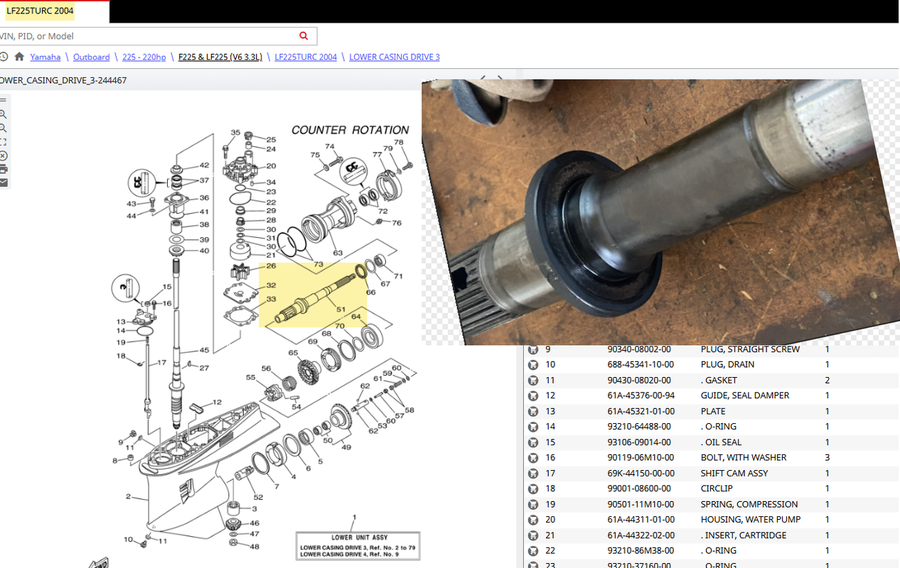

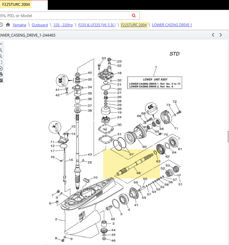

I was rebuilding my 2004 Yamaha 225 (F225 TURC) gearcase and there is a bearing and the larger bearing/race that I am not seeing on the parts breakdown. I have the correct year/model and it is not showing that shaft mid rig that the smaller bearing and large bearing/race ride on in the breakdown. Can someone help with the part numbers?
-Forward Gear bearing & Race
-Smaller cage bearing (name?)
I hope I was clear in describing what I need. Let me know if you need any more info..

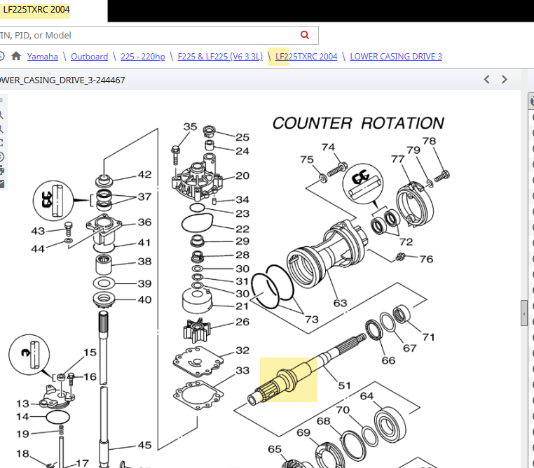

The propeller shaft shown in your photograph looks to be that for an LF225TURC.

All I think is that the propeller shaft picture in the OP's post looks more like an LF225TURC propeller shaft than it looks like an F225TURC propeller shaft.
Not unheard of for an LF225 gear case to be installed on an F225 motor. Or vice versa.

I saw the bearing listed on the left hand drive list and it started making sense. Yes, the label does in fact say F225TURC on my engine, and my prop turns like the right hand drive should.
My drive sat longer than I wanted and didn't have oil in it. The seals were tired and some moisture got in and wreaked havoc with all my bearings. Gears and fine..

Sounds like an LF gear case being shifted and run in reverse so as to go forward with a right turn propeller.

Okay, I'm an idiot. Sorry, the back of my unit has an 'L' indicating a left-hand operation. I should have looked and knew to do this.
