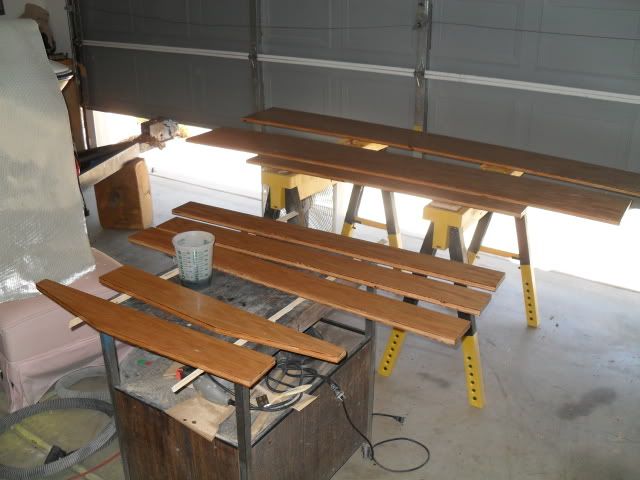

Installation of sub-deck
Since my stringers are foam cored, I did not want to screw the deck into the foam stringer, I so capped all the the stringers and bulkheads with 3/4" ply and held in place with peanut butter.
Sealing the under side:
Stringer caps fitted and ready to be sealed on the top side:

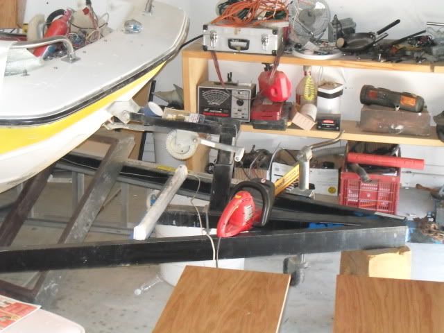

Trailer re-design
Trailer re-design
Since I have to do all my work in my garage because of the HAO I may need to either change my trailer or reconfigure the front of it to deduce the distance between the boat's bow and the hitch point, which is currently 5 foot. At present I do have room for the sterndrive.
Trailer:
Can this configuration be safely modified?
