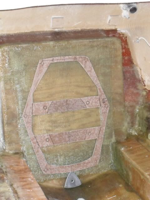

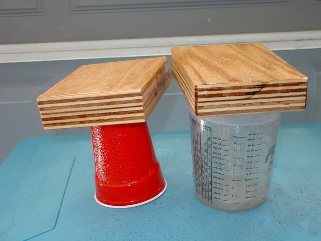

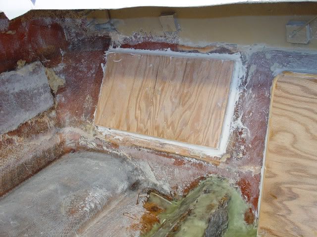

I had cracks in the gelcoat where the ski hook was fitted, what a surprise no support bracing was fitted to the inner

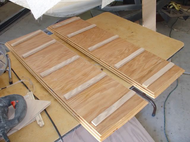

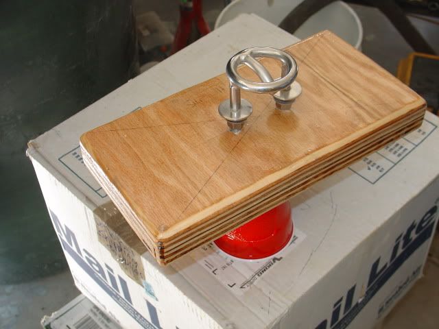

I had enough pre-joined plywood from the transom build to make a brace for the ski hook, plus supports for the two lifting rings on the stern. These (when fitted) should be strong enough to pull a houseboat without flexing/cracking
Again, everything wooden is encased with 2 or more coats of resin.
New Ski Hook Brace
New Lifting Rings supports
