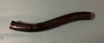

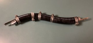

I got the blocks and risers on the port engine . . .
Most of the hoses are an inch or so short, because of the new fitting locations. So, I'm fabricating a few hoses of the new fittings.
The original coolant return lines were about an inch short and needed more of an 'S' bend. I am trying to fabricate custom hoses by setting their shape and baking them.
Tomorrow, I will move onto the the starboard engine . . . which I hope goes a bit faster than the port engine. :unsure:
