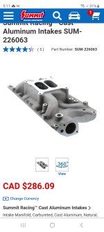

So many intakes to choose from...any thoughts on this
