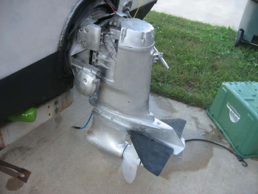

i have a 1972 IMP not sure of which model .. has a cuddy cabin, is a stern drive..i recently puchased it because it was failry cheap but has no engine ...i purchased a 1985 mercruiser that was supposed to be running perfect but ended up having a blown head gasket ..so i got to do my first head gasket job ...it was pretty simple... engine is great now but it is not going to mount in my boat like it was mounted in the other boat..i beleive i am going to have to build up some type of blocks in the engine bay and fiberglass it to the boat. there is a part on the boat i took the engine out of that has a sticker on it that says MARINE j1171..i beleive it is the trim pump ...do i need this on my boat or not ? i think the guy has already sold it to someone else ...also how can i hotwire the tilt motor ?? to see if it works and to get the outdrive up so that i can pull the boat around without havin to wrry about the outdrive hitting the ground? i know this is alot of questions but i have many more lol this is my first boat and i want to do as close to perfect as i can and everyone on here seems to know what they are talking about..thanks

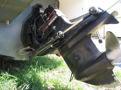

ok...do you have THIS (thanks lowkee...lol)
or this (God help you)

Ok...well....
That is an OMC strndrive, OMC has been out of business for a number of years, parts can be very difficult to come by as well as tech support as far as shops to work on them.
You stated you bought a Mercruiser motor??? I can be wrong, however I am not thinking that will work for you as you need mercruiser everything. not a merc motor and a OMC drive...
This is now honestly outside of my realm of knowledge, so now that we know what you have, the schmart guys can chime in and help you
Good Luck and again, Welcome!

ok sooo...now u guys are kind of scaring me ...but...the mercruiser will bolt up to the omc outdrive..so i really dont see any problem there...if there is anyone out there that knows if that really matters lemme know.....
Ayuh,.... You Will....

You have a boat (glasser I assume) Merc engine (runs good), OMC Stringer Outdrive (obsolete by most pros standards)....
You'd be working on two different puzzles there as I see it.
So here is what I am thinking you are facing...
Option #1
Keep the boat, sell the Merc engine, buy an OMC Stringer engine, mount it up with the outdrive.
(This is a horrible, terrible, nightmare of an idea:eek::eek:)
Option #2
Keep the boat, keep the Merc engine, find a good Merc outdrive, glass up the hole in the back of the boat, recut a hole that fits your new Merc setup. (I don't think this is a good idea either).
Option #3
Sell the boat, sell the outdrive, (you probably won't get much for either of those items though) keep the Merc motor, find a good boat that had a good Merc outdrive but needs a Merc motor.
(May or may not be a good idea but likely better than the first two.)
Option #4
Sell off the Merc motor, OMC Stringer outdrive and start looking for an Outboard and a bracket. (Likely a very, very bad idea)
Option #5
Sell off everything you have there, cut your losses and start your search for a new rig that has a complete, more up to date driveline (Merc or VP).
(Probably the best route to take)
Again, I am entirely a rookie at this whole deal and am working my way through a similar situation.
I do know that where I am off the vets that hang around here will certainly correct me.
All the best man!!
Gary H NC
Dec 1, 2005
8,972
Re: rookie boater needing information
Option #5 above is your very best advice!
They have not made those type of OMC drives since 1984.....Obsolete and parts are very rare.
Sell it all and start over...;)

I know even less about I/O's than I do outboards, but I agree with the choices outlines above.
I would opt for 3 or 5. There are a TON of boats out there that have bad motors, but good outdrives and can be purchased very cheaply and are already set up for Merc engines.
If you want to keep that boat it will a big job to rebuild the transom and then cut out to install a Merc outdrive.
The bracket idea is a viable one(albeit expensive), but without looking at a photo of the boat it's tough to say whether or not it is feasible.

Is that an electric shift OMC you have, or do you know?

i am pretty sure it is electric shift because there are no cables (except for steering and throttle) that go to the front of boat ..i looked up under where the throttle lever and shifter is and there are only wire going to the shifter part.. sorry if i seem like a clueless idiot but i sorta am with all this boating stuff but am eager to learn as much as i can to help some one out one day if they find there self in the same situation..or should i say "in the same boat" lol
