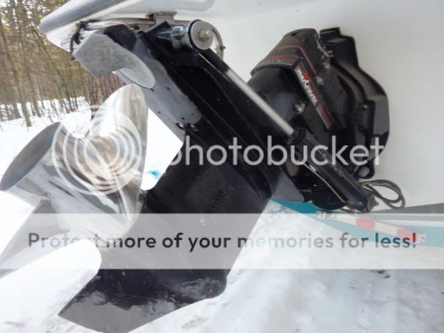

Basically, if you have one of these...
...and one of these...
...they do not work and play well with one another! Two entirely different systems.
What you will really need to do is find yourself one of these...
You'll also need to deal with this giant...
...which won't work at all with either one of those Merc items.
I hope at least some of that makes sense.
Moving forward with the project you have on your hands will likely take a lot of time and a lot of money. You'll probably spend less time and less money by going with that last option I outlined up there (so long as you play your cards right).
Though anything is possible given enough resources, eh!
All the best:)

ok pics awesome.....exactly what i have as far as engine and drive...but still noone has told me why i cant combine these 2 ...if they will bolt up why will it not wrk ????what are the consequences? i understand that mercruiser is built for mercruiser and omc is built for omc but if they bolt up the same why are they not compatible ?
