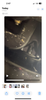

Hi, I’m new, I have a relatively slow saltwater leak as per photos/video in. Drip coming from the underneath of the engine side of the middle of the exhaust y pipe. Small volume of water pooled below prop shaft as per photo but very hard to see exact source. I know steering pin leaks common but that looks ok superficially. So that leaves exhaust pipe leak or leak from the prop shaft? I’m hoping the engine doesn’t need to be pulled out to be fixed. Any help much appreciated.

It could be the Y pipe but seeing it's on top of it I would lean more to the drive shaft boot. When was last time the boots were inspected/changed?

Was only serviced and inspected 2 months ago. The drip is coming from underneath the y pipe.

I see it coming from above it,
Does it only leak when motor is running?

Check/feel under the raw water hose connection at transom plate, see if it's wet

Ok I’ve found the leak, small amount of water coming from top of y pipe exhaust where it goes through transom. Only when engines running. Checked the steering pin where it goes through transom and seems dry. No other leaks detected. Photos of when leaking and when dried off. So my next question is is this a seal issue? Presuming when engines on the turbulence causes it to leak. Also presuming to fix the boat has to come out of the water as submerged when boat in the pen. I’m thinking the recent stern drive service may have slightly disrupted the seal as it wasn’t leaking before hand. All your help much appreciated!IMG_5215.jpeg

Y pipe repairs require boat out of water and engine to come out.
Can not see where any maintenance performed would effect y pipe to transom seal.
Have seen the situation where the O-ring between the y pipe and tansom assy leaked from built up corrosion and have seen where exhaust flapper failed and fell inside the exhaust y pipe and the S/S rod / pin that holds them ate thru the aluminum y pipe, causing a leak. Solution was a new Y pipe and flappers.

I'm unable to identify the water/leak, but either way the motor has to come out

Check and see if the clamps or rubber connectors at top of Wye pipe are leaking when the engine is running. If it was leaking at bottom of wye pipe this would leak while not running as it is under water.
