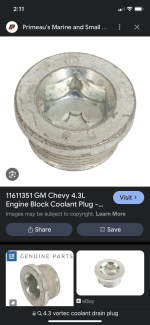

Okay I did find intake manifold drain. Is the port side drain plug this big boy in front of oil filter?
Lou C
Nov 10, 2002
13,970
That looks like it; these are a little different than the ones on my older pre-Vortec 4.3. Just make sure that the Allen wrench really fits right, there are both metric and US inch sizes, if it doesn’t want to come out try heating the cast iron around it. With those plugs I would coat the threads with gasket sealer like Permatex Aviation that will keep them from getting stuck.

Thanks I did find the block drain on port side …needed a big 17mm Allen wrench so that one I had trouble finding as I was looking for a plug that looked like all the rest.
I haven't heard of this; that drain isn't big enough for a 17mm anything
It looked like this and the location was shown in the manual I just wasn’t expecting it to be that size
That's listed as a freeze plug drain on lt engines from what I'm seeing. Definitely isn't the standard drain. Port and starboard are the same size, ¼" npt I think.
If it's somehow a threaded core plug you're probably fine. Maybe post a pic of where it came from.
