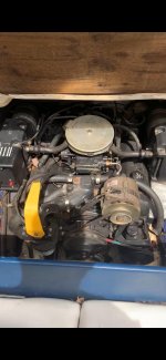

That I can’t say, because my OMC Cobra doesn’t have that set up. Why not post a pic of yours?
Sure thing...here is mine. I only see the 4 hoses coming off the tstat:
2 to the manifolds
1 to impeller
1 to circulating pump

My OMC manual said the same and I felt the same as you. What I do is disconnect the raw water hose at the 'stat housing and fill that hose with -100 (-50 freeze point) marine antifreeze till it runs out the water intakes on the outdrive. Doing this 20+ years and never had a problem.
Yours is different due to the impeller being on the engine but you can do th same thing. First mark the hoses so you don't mix em up. Then disconnect the hose coming from the transom to the impeller housing. Hold it down to drain it and then hold it up and fill it with marine AF, till it runs out the water intakes. This also flushes water out of the P/S cooler on the back of the engine. Next I would disconnect the hose going from the impeller housing to the 'stat housing at the stat housing. Then fill it with marine AF till it runs out of the impeller housing. Reconnect the hose from the transom to the impeller housing, and then keep filling the hose from the impeller housing to the 'stat housing till its full then re-connect.
If you get close to zero *F, do not use -50 or -60, I would use only -100. Those will get hard at about zero, which you do not want in a cast iron engine!

In your response earlier you mention "Next I would disconnect the hose going from the impeller housing to the 'stat housing at the stat housing. Then fill it with marine AF till it runs out of the impeller housing".
Is that something I should / could still do at this point with all the AF I already have in there? I'm not sure if I disconnect that hose now if all the AF I have already put in will come flowing out. Probably overthinking it considering it is just for anti-corrosion and I think what I did earlier would have gotten all the water out.

I don’t think much if any would come out if you did that…
