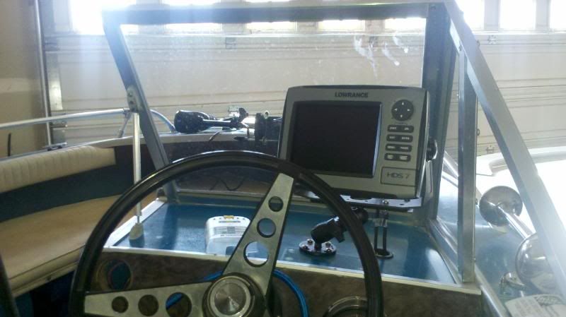

I finally got my GPS/Fishfinder installed and mounted.

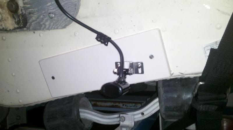

I don't have a picture of the mounting of my transducer yet. I'll get one posted. I used a transducer mounting board then screwed my transducer into the board. Let's just say I wish I didn't have to drill any more holes in my boat, but I have to install a bilge pump exit and through-hull fitting. I don't know how many times I have looked at the starboard side of the boat, just coming to terms that just looking at it won't get it done.

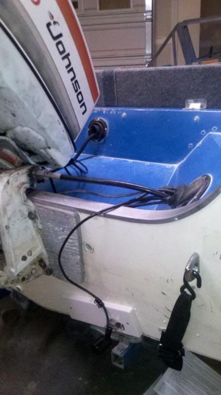

Here are the pics of the transom with the tranducer board, and transducer mounted to it. I don't have the clips screwed down yet. I'll get that done tomorrow. I didn't have the correct length SS screws for the clips.

Took the boat out a few days ago with the family. First 2012 trip to the reservoir. Great weather for March (65 degrees). Fish finder/GPS worked great. I have some noise issues that are showing up, but I have since made some changes that I hope improve that situation. I also have a nice rooster tail from the transducer. I'll try and raise it up a little to see if that helps. No leaks from the transucer mounting. Got the throttle up to 4600 rpm at 34 mph. There is still plenty of throttle left. Thinking it will do about 40-43mph. I am not one for speed, so I don't know if it will ever see full throttle to find out how fast it will go. We just enjoy being out on the water. Finished wiring up the electric trolling motor (Transom mount). The transom mount is what I have from our 12' Starcraft, and should do the job for now. I am looking for a cheap way to disconnect power to the trolling motor without removing the leads from the deep cycle battery every time.

The transducer centerline in the horizontal position should be even with the bottom of the hull. Looks about right where you have it and where it is. You may triming the boat a bit will solve the high wake off the transducer. great place for a boater to live ,lots of options to choose from.
We have not spent a lot of time in the boat since the 85hp has been mounted. I'll play some with the trim and see what happens before I start changing the height of the transducer.

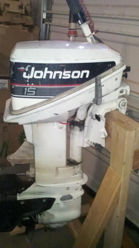

Well Craigslist has struck the pocket book once again. Came accross a 1989 15HP Johnson with a mirrocraft 12' boat and trailer for just over $700. The PO then pitched in a brand new $200 seat in the box with an 6-8" pedestal. I can probably sell the boat and trailer for about 4-500. Keep the johnson and the seat for the SC.
