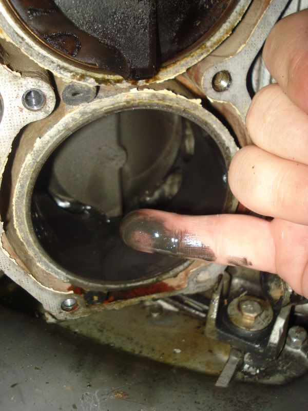

I noticed a bit of silver in the oil I shot in the lower cylinder (the one that's low between 70-80psi). Is that a sign of a scorched cylinder wall or bad ring? (please say ring):eek:

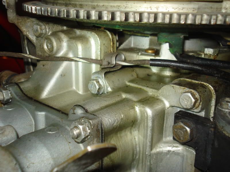

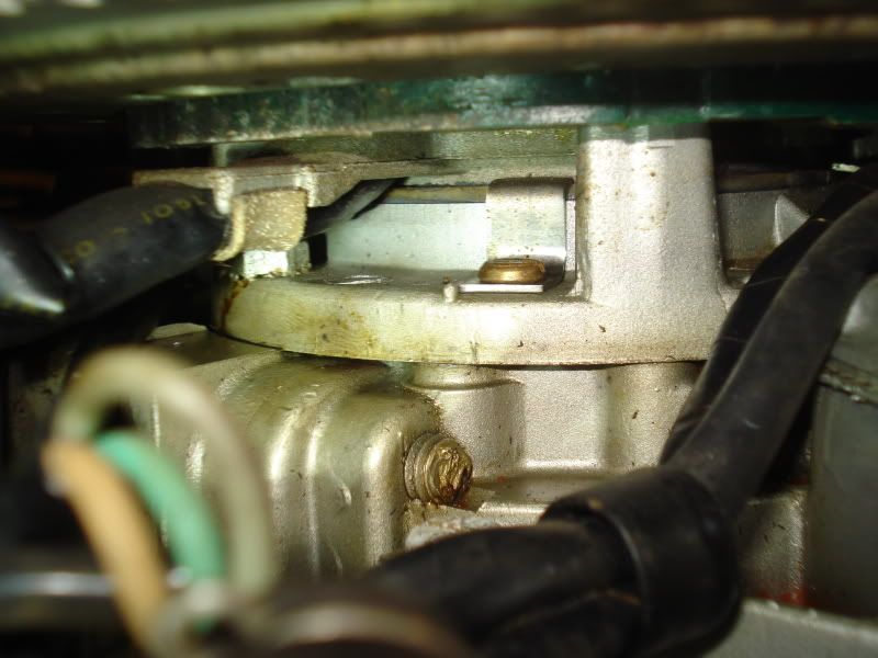

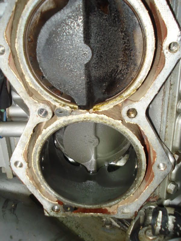

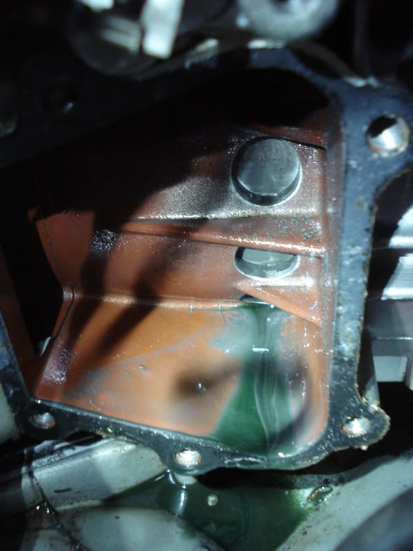

Gasket leak at intake or main bearing seal

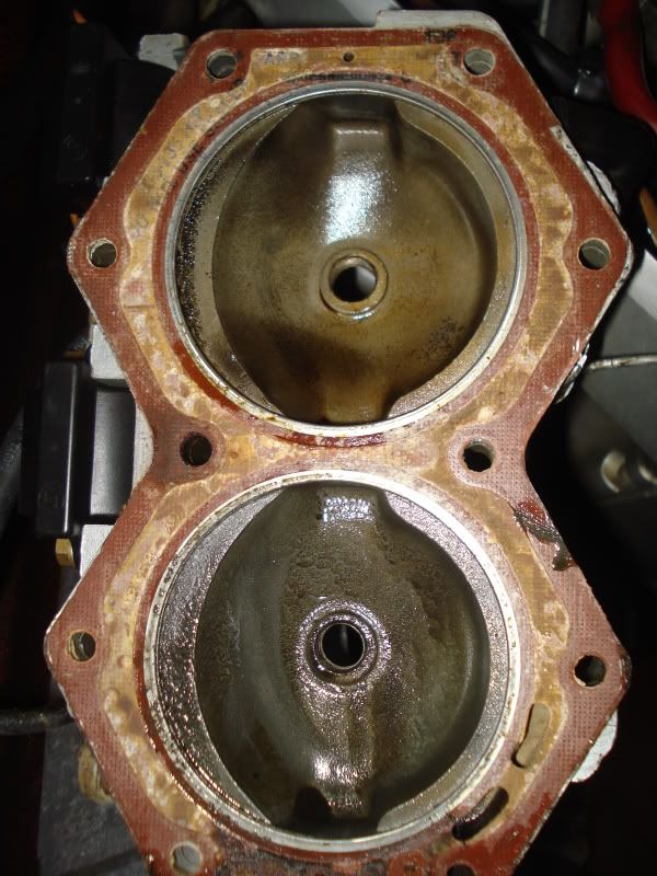

Removal of head gasket - lower cylinder is the one with low compression

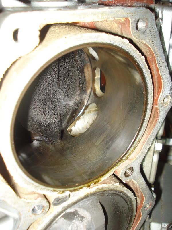

Silver color in oil in lower cylinder? Is that the ring?

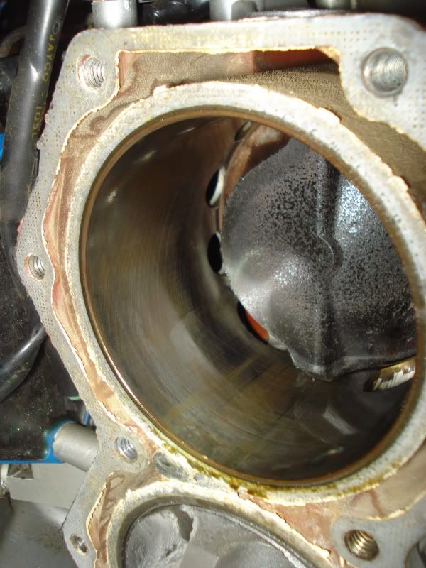

Lower cylinder - exhaust port
Top cylinder - notice fine machine scratches in wall, lower one was smooth and no scratches at all

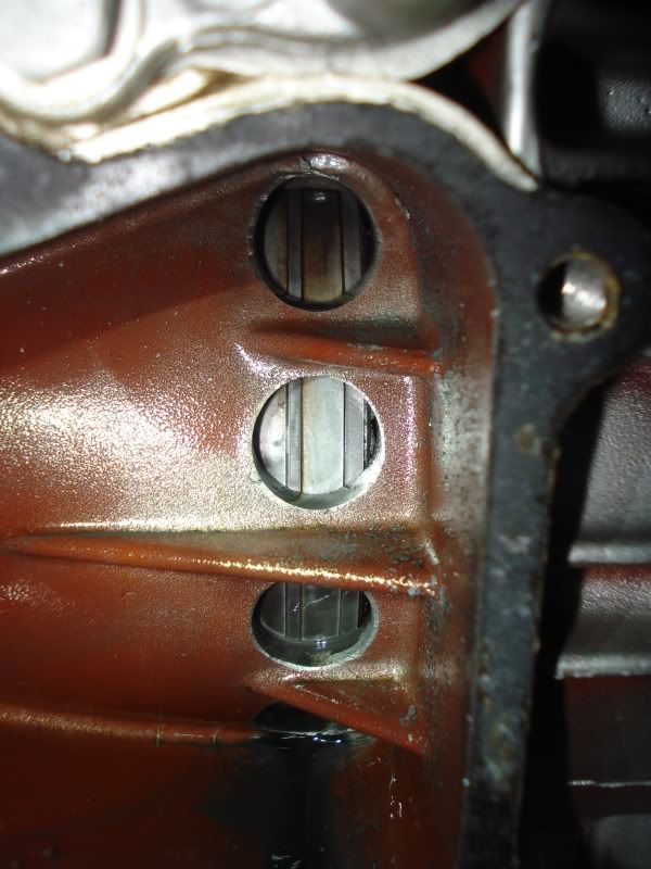

Backside of gasket cover

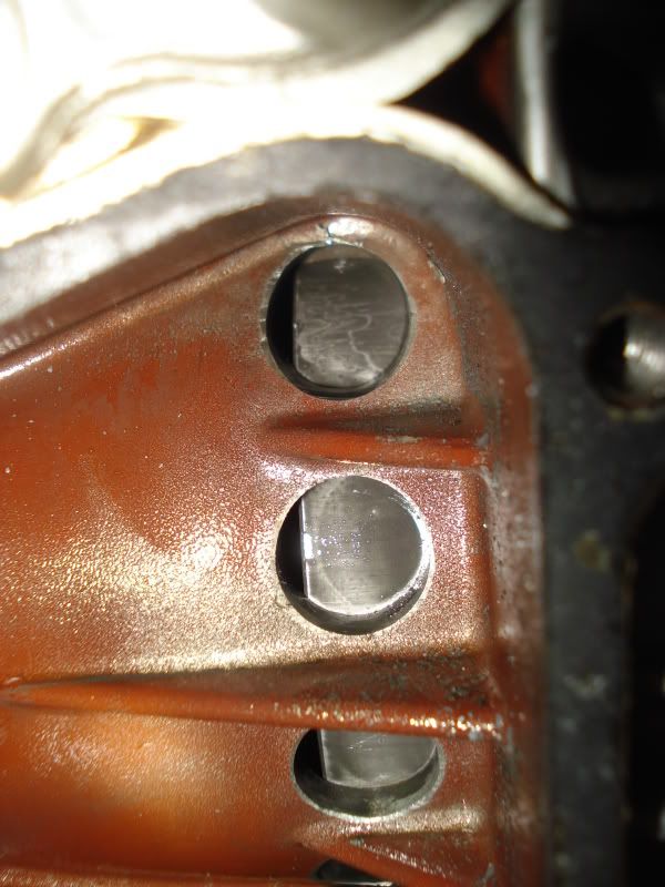

Removal of bypass cover on lower cylinder

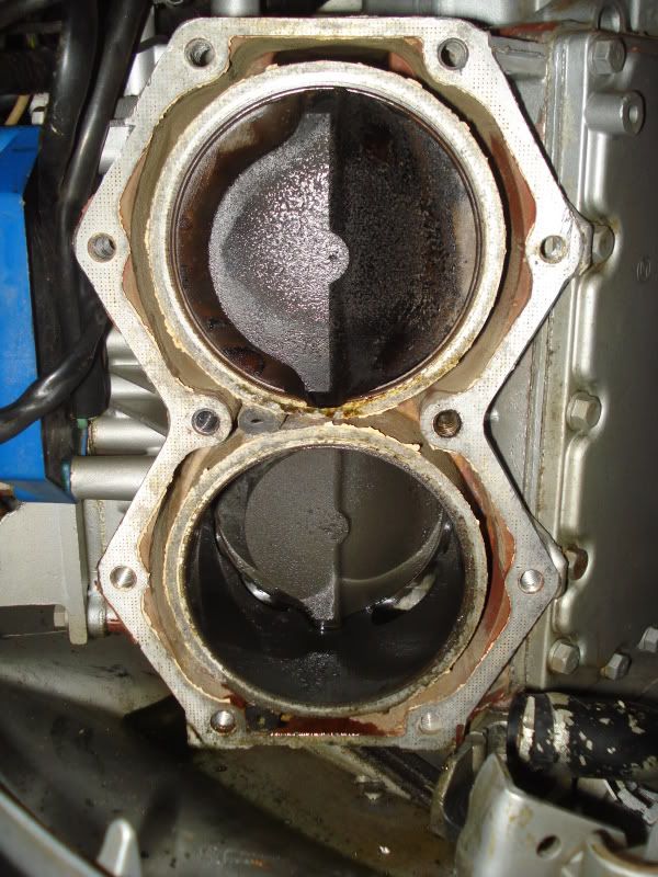

Last post with pics....sorry so many.
Cylinder Ring
Cylinder at full stroke

Wow, a lot to look at and it looks really good for it's age. No broken bolts, no corrosion, water passages are clear and just a bit scaled. You have had some water in #4 and the rings are worn. Maybe a very small water leak starting in #2 but no signs of damage in #2. I would expect 1 & 3 to look like #2 based on comp test results, possibly #3 a bit worse because the lower cylinders normally get wet sooner.
Needs head gaskets and I would replace the water passage deflectors (the rubber hose looking pieces) even though they look really good, they might be ready to crumble.
Doing rings on #4 piston is your call and cylinders would need to be measured to see if they are still in round tolerance. Ring job involves splitting the crankcase open, uncapping rod and pulling piston at the very least and can get much more involved. I would run it like it is with new gaskets, you won't be at 100% but you'll have stopped the water damage from continuing and your compression may improve on all four. You saved the motor, a lot of money, and it will run like a good used one.
The leak on top is hard to judge from pictures. There is a case (crankcase head) that holds the top crankshaft bearing and seal. The case has an o-ring that seals it to the block, it may be leaking and the crankshaft seal may be leaking. No really that big of a concern unless you lose a lot of crankcase pressure and reeds don't fully close. From what you describe running-wise, I would think the reeds are working OK. If you want to change the o-ring and crank seal, you can probably do it yourself, involves pulling flywheel and you need a puller for that. Since the bolts all came out, the flywheel will probably pop off pretty easy too. You would be able to inspect the stator and timer base as well.
