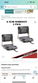

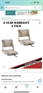

Looking at these for passenger seats on swiveleze mounts that can me moved around. Only plan to hunt 3x, could squeeze a 4th.
I’m torn between the color scheme, any input?
