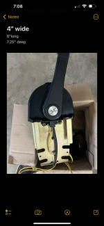

I got pics of the side console, I’ve since taken it apart and am redoing the wood, and also a pic of the control that came with the motor. Sorry if some of my questions are dumb, this is the first boat i ever had.
The dimensions on the control are roughly 4”x6”x7.25”, so that mounting bracket i sent won’t work, but i can prob bend something myself that would have 5” on top for this to sit in
