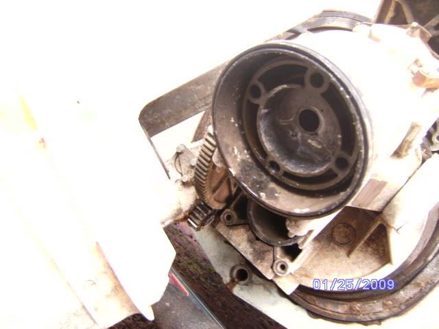

ok i got down to the water pump, and both spline gears are good and the water impeller looks to be new. i still cant see any gears yet, but its not the lower foot thats locked up because i can spin the prop in gear now. I still cant turn the main drive shaft in or out of gear. it is something in the upper unit because the i cant turn the ball gear (also new) for the upper drive.
that was kinda of easy too. so how do i get in there to those gears?

Re: Stuck Motor
When the water pump came out the 2 shafts and a pinion gear in a bearing carrier should all have came out.
Then you can see the ball gear And shaft, inside the upper drive.

the male shaft that the water pump is mounted to is the only thing that came out. this is where im at...

Re: Stuck Motor
Thats the top of the pump it has to come out hook a wire or something in the hole, and get it out.
Put a weight on something and use it as a puller.
I spun it to break the seal, but try not to break it. When you do buy a water pump kit you can buy it with the housing, thats the housing.
Understand grass hooper???

Re: Stuck Motor
You know what a slapper is we use it to pull dents in cars, have one or make one with a good strong wire bent on one end into a hook and the other bent so when you pull the weight to you it stops.
Don't pry on it between the side and the housing and crack the aluminum.

Re: Stuck Motor
so far its been a pain trying to get it out. was it to come out with the impeller shaft at the same time?

Re: Stuck Motor
Yes it was but sometimes they come out like yours.
There is a c clamp that must have rusted off.
And the new water pump kit will have, you would know that if you had a manual.
Not chiding you, i'm impressed , you paid attention to what info i have been imparting to you, keep going, you did understand about the slapper and pulling the water pump housing out?
Don't damage the upper drive casing understand ??
When you do get it out you will see the problem i can guess what it is, and probably be right, but you have the eyeballs on it and are touching it, so you tell me after what damage is in the upper and what parts we will discuss to get latter.
Now get it out grasshopper, theres still a long way to go before it kisses water again that drive.
