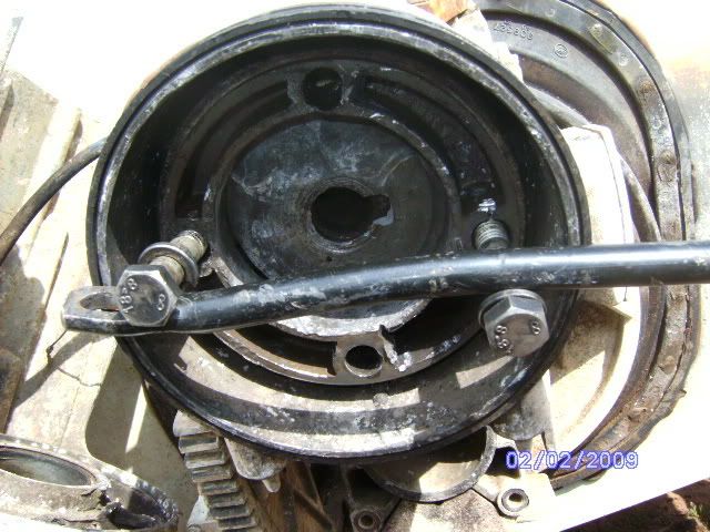

ok today i tryed a new way of pulling it.(PIC)
now that im able to spin it i have noticed that i have unlocked the upper drive, (that housing is in there that tight???) because the gear up at the very top is spinning now but its still kind of tuff to spin... but hey its unlocked now.

Re: Stuck Motor
So slap that mother out already, jeez i'm getting older by the minute i could be dead by the time you get it out.

Re: Stuck Motor
Ok CAREFULLY, VERY CAREFULLY, put some heat to the outside of the housing.
Keep it moving the heat.
Can you grab the shaft with a lock jaw plier?
The guts are all torn up inside the housing.
Might be cheaper to just get a used upper 400. They are on e-bay all the time.
I have seen the whole drive for 400 bucks.

Re: Stuck Motor
WELL I GOT IT OUT WHOOHOO!:D
its the bearing at the top part#21545, right under the gear. it has busted up and caused a jam.
