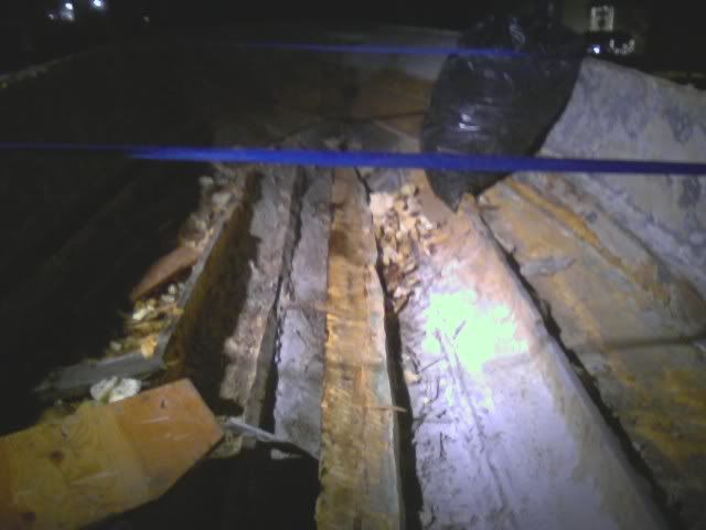

Alright still trying to get the stringers out.. can i just take a sawzall and go under the stringer and just follow the shape?

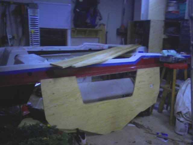

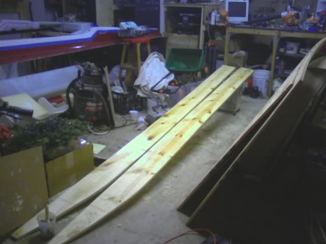

ok got the first stringer out and just traced it on the new board. got the boards for the transom too.. my parents want it out of the driveway soon. so hopefully i can at least to get the stringers in place and glassed and some pieces to hold the stringers in place so theres no deformity to the hull. throw the cap back on and put it up for the winter.

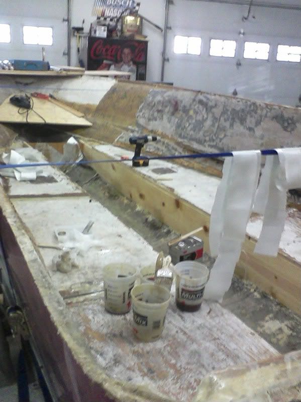

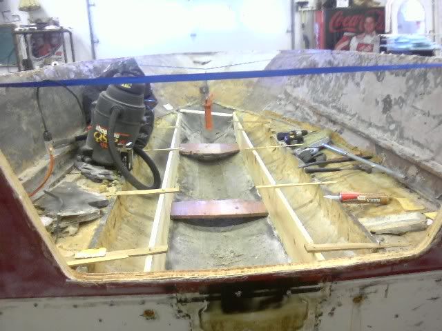

New pics.. i had a buddy come help me out so i can get it out of here.. we got the transom out. both stringers out.. started to grind out the left over glass.. i have to go buy some longer bolts to do the big clamps for the transom with the 2x3s .. with it starting to get cold here the resin is taking its time on drying. Heres what i have so far.

Re: The "New Boat"
Ok transom is in. I had to move it to my old bosses house into his heated garage.. its too cold out for the resin to set this week. Both sheets of the transom our in.. tomor i hope to get my roll of fiberglass over there and glass that in there and work on getting the hull prepped for the stringers. its nice and toasty in there. the weather her is getting colder and windier so the other day to prevent all the glass from grinding from getting in my eyes i had to use my paintball mask that has good goggles.. it workd tho. .. ill get pics tomor

Re: The "New Boat"

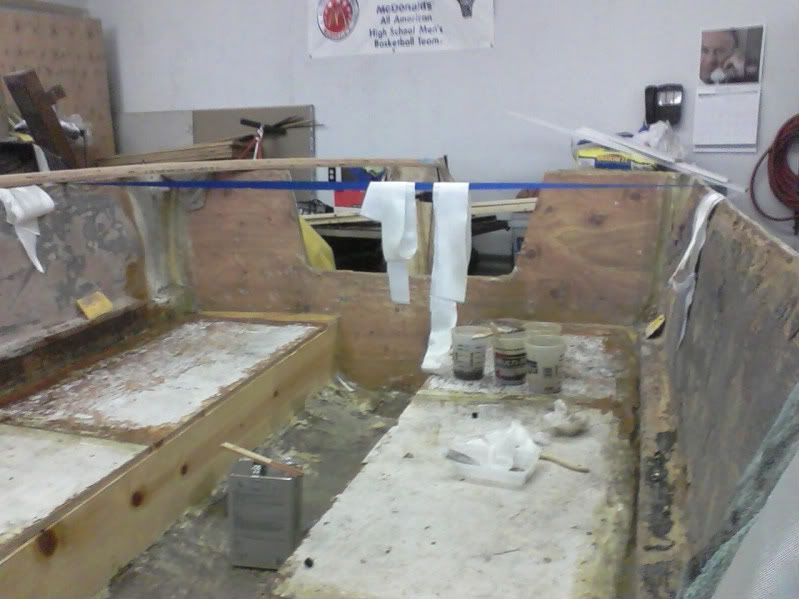

Transom is glassed in completely. inside of the string is glass outside is tabbed. foam poured in. deck will go on soon

Re: The "New Boat"
Update!!!
Edges all all sealed. will finish sealing the stringers tomor than i can bring the cap over

Re: The "New Boat"

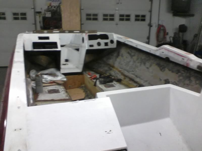

Update today got a lot done.. cut the braces for the middle completely glassed the hull so that no water can reah the foam.. and put the cap back on...

What do you guys think so far??? i had to get the cap on before i finished the middle of the floor due to some crappy weather coming in
