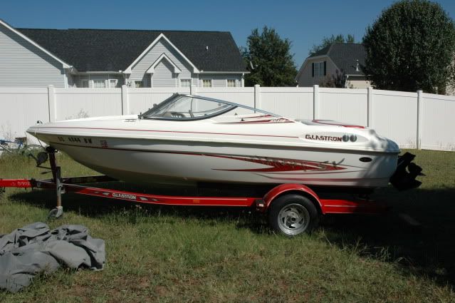

I have an update. I was able to put eyes on the Glastron this afternoon. I have mixed feelings right now and don't know which way to lean. Seller stated the boat was always kept under a carport or in the garage. The boat was covered sitting behind the pool fence in the backyard (stated he had to move it out of the garage to park a vehicle inside while he was out of town).
The boat as soon as it was uncovered...

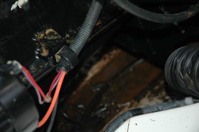

I found debris (leaves, dirt, etc.) in all the under seat storages and ski locker. There was old, stagnant, standing water in the very forward partition of the ski locker just about up under the bow area. I also noticed the drain plug hole appeared to wet and found wet "goo" when I inserted a finger. Upon opening the engine bay I discovered the very bottom portion under and to the rear of the block filled with what appeared to be old, wet, saturated leaves and trash that could not drain out of the plug hole.
Look in the center of the photo (could not focus right in the dark with sunglasses on)...

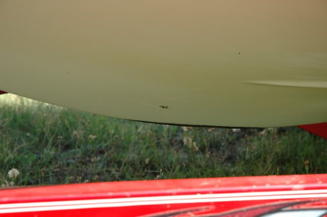

The boat was clean for the most part. A good washing would take care of the rest and the engine looked fine. Did not appear to have any leaks that I could detect. Maybe the water made its way in and they never cleaned it out. Don't know. Just don't really like that the water just sits there. My main concern is the hull. I noticed on the very bottom of the "V" hull you can obviously see where the boat has been "beached" many times. The white gelcoat is rubbed off and you can see the natural color fiberglass. Just above that there is a chunk of gelcoat missing in what appears to maybe be a rock strike. There is an actual hole that reaches into the fiberglass.
If you look in the following picture the rubbed area is at the bottom and appears to be black colored with the hole just above...

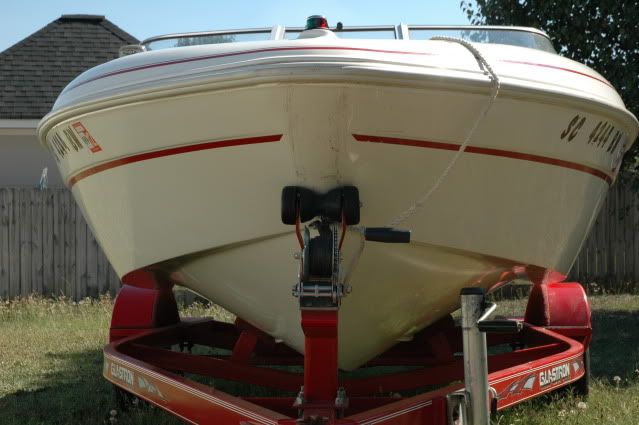

There also appears to be very rough trailer loadings because in the following picture it appears the bow roller has rubbed the underside of the bow gelcoat...

The hull damage is hard to see in the picture. There is a patch about 12" long and 3" wide where all the gelcoat is rubbed off and you see the "clear, natural" fiberglass. That spot on the bottom of the hull appears as the black line in the picture above. I just couldn't get a picture from underneath showing that with the camera and lens I had with me. It is NOT black, it just appears black in the picture due to the lighting and shadows. I am rather concerned about that spot and hole in the hull just above the "rubbed" area.

Looks to me like the "hole in the hull" is more than likely from beaching on a rocky shore. No big deal but you should seal it. Water will wick up through the fiberglass.
Get yourself a gel coat repair kit. When you screw up the first time sand it off & try again. You'll get better ...

The gelcoat scratches appear to be pretty minor. The chip could be filled with Marine-Tex white (it won't match, I know), and the bow roller marks are no big deal. I'll bet they aren't even due to "hard loadings" per se. Those black rollers can just leave lots of marks. And that part of the boat is always out of the water anyway. Is the cover water proof? But you did kind sort of catch one lie already, it's not always under that carport or under the cover. Not with leaves in it.

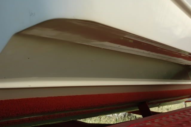

Is this something to be concerned about?
I am assuming this is gelcoat blisters. Should I worry about it or not? If I should, how would you repair it? Thanks.

Those little bumps do appear to be blisters, yes. That is not good. A boat kept on a trailer should not blister. So that thing has been left in the water for longer periods of time that you have been lead to believe, or that you heard. Gelcoat blisters are labor intensive and Expensive to repair PROPERLY. Search on here, you'll read all about how to repair blisters. It ain't fun.
Agreed. Much as I like Glastrons I think I'd pass on that one. The blisters affect performance and more than likely will eventually crack. Allowing water to wick into the surrounding glass cloth. And they're a real pita to repair correctly. Pass.

I was for the Glastron until I seen the picture of the gelcoat blisters. You really should shy away from this deal but there are others out there... just keep looking. I have the GT-185 with the 3.0l and it's not a speed demon but managed to thrash my 300 pound BIL on on oour tube with 3 others onboard.

Its a typical lake in SC, not anything like the Great Lakes. What surprises me is that is the only spot with the blisters. I would think if they appeared in one spot they would appear all over the hull. I know you'll say it is expensive and difficult to repair, but how do you repair it? I am assuming that is something left for the pros. I just really don't want to make that the deal breaker. Seems to be a good boat otherwise.

So far ... Sounds to me the boat has not been quite as meticulously maintained as the po might have you believe. And it appears you're trying to talk yourself into it regardless. Don't do it. Pass. Be patient. Leave your money in the bank & shop for something in better condition.

I have to agree with the others. Earlier I stated I would purchase it but if I would have seen the blisters I too would pass. I know it's hard to pass up what looks good, but being patient will pay off for you. If I knew where you are in SC I would be happy to scan for some nice boats for you. Sadly, many have lost thier jobs and are forced to sell boats way below nada. I found, looked, and purchased mine in 32 hours. It can happen that fast if you just take the time to find the right one. If the fiberglass has started to wick, tou'll never forgive yourself for a rash decision. I used to suffer from "buyitis" years ago. I got my heart set on something and there was no stopping me from rushing out to buy it. Ask yourself, how long have you not had a boat? Let me know where your located and I'll be glad to scan some boats for you.
