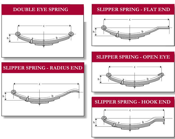

Make sure we're on the same page. Looked at 5 tandems trailers last night. All but two had "open eye" springs. The others had torsion axles

Not sure I understand your pics show only one 'open eye' the other four show at least one closed eye?
slipper spring open eye is what was on my trailer, replacing with double eye.
What was the reasoning / logic behind changing from the open to closed eye spring? The open eye has fewer moving parts and provides a smoother, level ride do to the nature of the design

Given one of the fist pics in this thread with the open end (C) just about to fall off the rear it just seems logical to have closed. I will never let my springs get to the point they were (now that I'm educated) but still...

I looked at my trailers again. One has the open eye and the other has double eye spring. The one with the double eye spring has shackles where the spring meets the equalizer.
On the one with the open eye, the open eye is toward the rear of the trailer on each spring which means one the front spring's open eye is at the equalizer.
Never seen such a thing. Is that factory or Harry homeowner at work?
On mine, the open eye is at the rear of both springs. Front spring, open eye on equalizer. Rear spring, open eye on trailer bracket.
how would the open give a smoother, more level ride by design?
In the c design, the spring is "floating". Nothing to rust up and seize the action of the spring. I've cut more seized up multiple bar equalizers off than I care to remember. I imagine they are not as problematic in freshwater, but pita in salt.
On my trailer with the open eye, mine is the same way.
mine was rear on both as well
Never thought of that, and yes i'll be in fresh. Would those greasable bolts help any?
