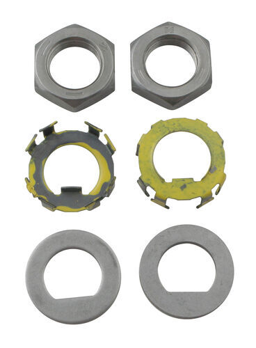

The king nut locking mechanism is a bit different than I've seen before. Had to study on it a few to make sure I didn't jack anything up when removing it. Kinda like a clamp over the nut rather than a cotter or a tab.
