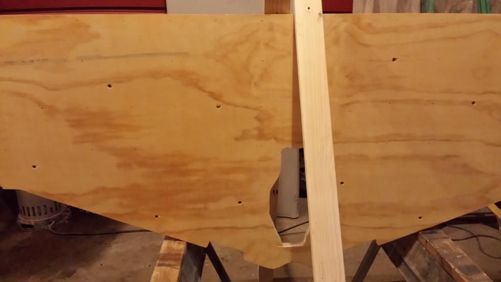

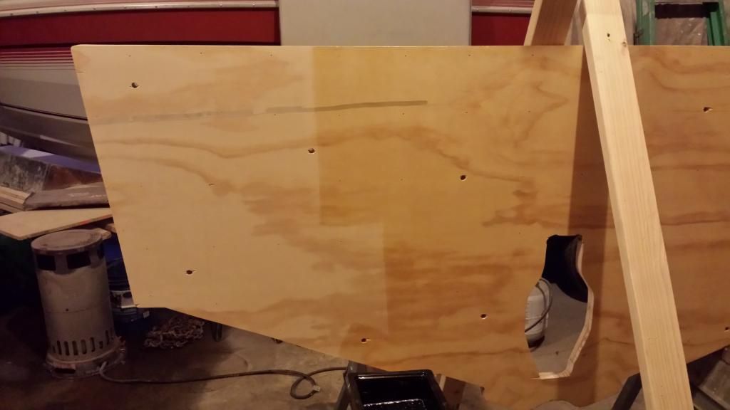

I have a total of 4 coats of epoxy on my transom core! It's like glass. I also cut the drain hole section out to prevent Wicking. I'm Going to cut a piece of 3/4" pvc and but it up against my brass drain plug, my hull, and fill in around it with pb. Don't want this to rot again. The epoxy is curing excellent! That's whyi bought the winter blend. Cures great at 40?! I'll have it at 60? in the shop so it will cure real nice.

To set that pvc pipe in your garboard plug hole ...You need a long enough bolt to go through the pipe and the garboard plug out the back of the boat,some fender washers and nut. Put some 3M 5200 on the end of the pipe where it contacts the plug area.. bolt and washer thru pipe..( washer should cover hole but not beyond pipe diameter) then the other washer and nut on the outside of transom skin and snug up to capture together... Now you can set transom and pb in all around the pipe making a nice slope into the pipe. ;)

I have my clamps cut and drilled, 4 coats on my ply, I dry fit today, cut a 1/4" on the top on both sides half way down. Tomorrow morning I'm cleaning with acetone, putting my putty on and sticking it to my hull! I'm nervous, but really excited. I'll post pics when I'm done.

You go boy! keep some paint sticks and putty knives around to work the excess into filets. Looking forward to your results which I'm sure will be just fine.
