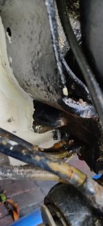

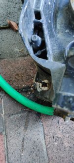

Here are the pics of the broken one on the boat vs the new on with the square opening

Bondo
Apr 17, 2002
71,418
Ayuh,...... That's where the aluminum anode blots go through the transom,.....
No difference,......
