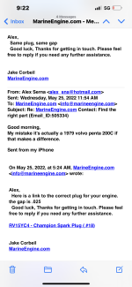

Good morning mates,
Another question before I came to this forum I asked a marineboaring forum I forget what it was called but they said the gap was .025 now so I do what this forum says or what they say that’s a big gap diff in my opinion. Thank you fellow boaters
