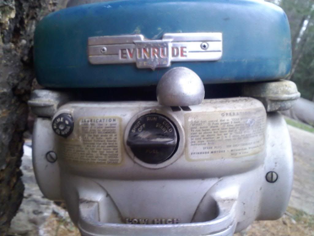

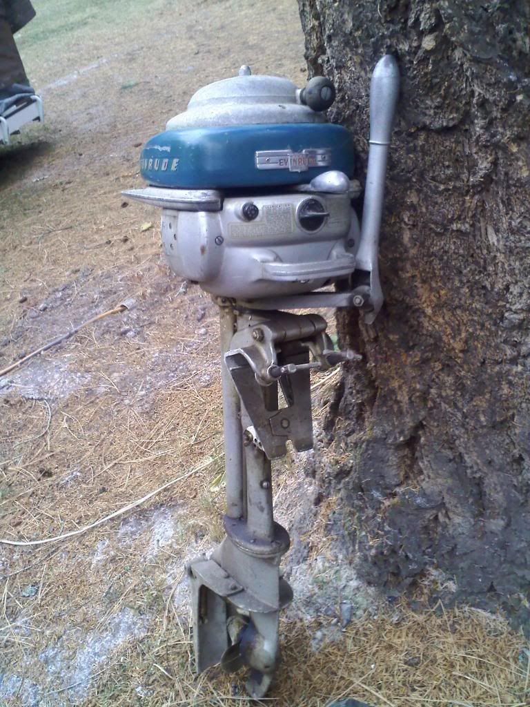

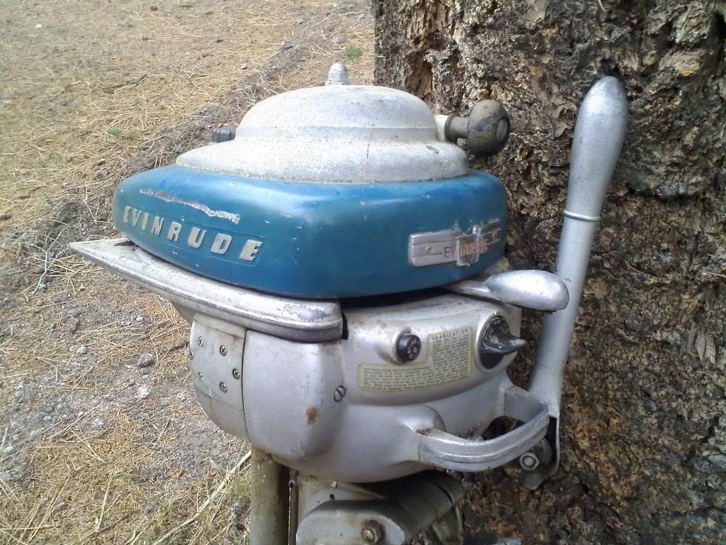

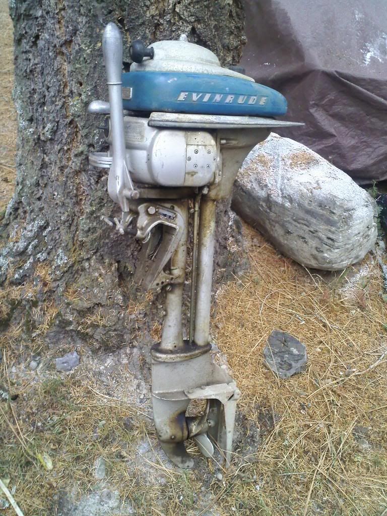

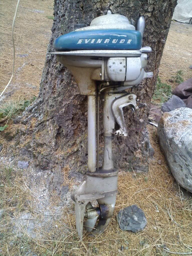

Met him this a.m. and was happy with the cosmetics. A couple scratches here and there. No dents! Gas tank is pretty clean. The only thing I see missing is the sticker for the magneto placement. It also looks like it had a gasket under the gas cap which fell apart and a slight stress crack in the plastic cap itself at the edge. He was asking $125 for it which was too high in my book but after some I took it home for $50. Even has a trolling plate on it so she should do wonderfully as a troller. Now to try and make her run and clean her up.
Now I need to find point and spark plug gap specs and see if it has spark.
As far as spark plugs go the sticker on the front is missing bits of verbage but it says to only use a Champion J10 com???? My searches pointed to J6 plugs. It has J8s in it now. Napa couldn't find anything related to a J10 Champion.
I usually run Amsoil Saber 100:1 in everything but mix is closer to75-80:1 and have had good luck. Any recommendations on mix assuming I can bring her back to her glory? Sticker say 3/4 pint of non-detergent 30w to a gallon of gas for the first four hours, then 1/2 pint to a gallon. If trolling they say 1/3 of a pint to a gallon. I'm sure I should mix it a little thick for the first four hours again since it's been roughly 30 years since the last hrs.
I also am interested in finding out what the best modern day grease would be for the lower unit. It says to remove both screws and pump it in through the bottom as norm. Must be a super tiny amount if I'm looking at the correct screws. There can't be much more than an inch in height difference between the two.

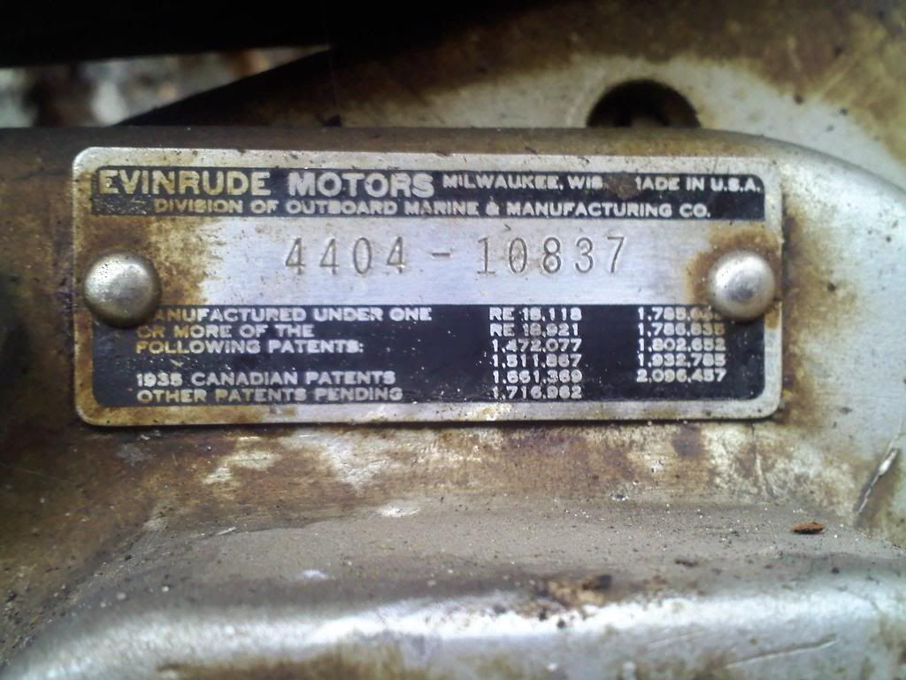

1946Zephyr
Oct 21, 2008
5,556
Re: Vintage Outboard Opinions Needed
Well, I think for your '56 AlumaCraft, you need a 1956 - 57 Javelin or Lark. That 50 might be a bit much for that classic. It likely is not rated for anything bigger than a 35, anyhow. 1956, the largest OMC available was a 30. Merc may have offered something a little bigger, but not much.
+3 on the old 5.5's. I own 5 of the little guys and all are good runners. Even if they look like hell, they often can be made to run nice.
Nice old Zephyr. the one in my avitar looked just like that one, before I restored it. Judging by the serial number, I would say that it's a '46 model. Mine was serial number 00066.

I would mix the oil as it is recommended on the tag. If it says half pint per gallon, then stick with it. The oil does more than lubricate - it also seals. Those motors generally don't have rubber lip seals, rather they run bronze babbit bearings, which also act as seals. If they're worn, the extra volume of the oil helps seal up the crankcase...
HighTrim
Jun 21, 2007
10,486
Holy Cow 80:1!? That little Zephyr wont last a summer at that mix, lol. Stick to what is reccomended, with todays TCW3 oil.
For the gearcase, use either John Deere corn head grease, or Lubriplate 105
Plugs use Champion J6Js gapped to 025 or 030. Point gap is 020
That serial number does place it as a '46. All 4402/4403/4404/4405s up to serial number 25000 were '46's
25001 to 40000 were 1947
40001 and up were 1948

......what is the purpose of the hinged plate thats behind the prop in the pics?......plz dont say its the brakes!! lol ( would love to get my hands on one of those little motors, but i do read that they can be cranky and unreliable?)

What makes a lower unit "weedless"? I noticed on you Zephyr it looks like some one added a fuel shut off or is that a wing nut for something?
I'm not 100% sure either. I've seen mid 60s-mid 80s bigger engines with them and always thought it was called a trolling plate. I am under the impression that it was a poor man's means of getting a larger engine to give slower speeds at idle. I can't imagine that it would reverse the direction of the boat. I think the later ones I've seen were cable operated up and down. This one on my engine is held in the down position by two springs so I'm guessing at idle you would have very little to no forward movement and as you increased the prop speed the force from the prop and forward movement of the boat would push the plate up. The greater the prop force/speed and forward motion the further up the plate would rise until it was straight out. I'm sure it will cause some minor unwanted drag at full speed operation but for my purpose of trolling it should work out great. I'm sure someone can probably give use the correct background on them.

Can anyone tell me which screws are used for filling, venting, etc. on the lower unit and does it get filled from bottom up? I see a screw on both sides of by the prop on the housing and also a similar screw 1/2 the way up the shaft on the front. (you can see them in my pictures in previous post) The higher one would be located above the impeller. Also any idea how much fluid it holds?
