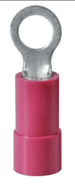

I would go out and buy a box of red ring crimp terminals for the component ends of the harness wires.
I'd also get a bunch of different coloured heat shrink tubing (of the right size) and heat shrink tube each ring terminal. Please don't be tempted to use spade connectors in place of ring terminals. Yes they are 'easier' to put on, but they also slip off a lot easier too.
You'll also need the right tool to crimp them. Don't buy a cheap tool, results will be poor. Get one like THIS.
