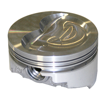

The KB D-shapped recess with 2 reliefs is a LCQ style piston when used with a vortec combustion chamber.
How is this piston D-shaped? From the picture it looks round, except the two reliefs.
if they are starting with virgin blocks, deck height is a given. if they are dealing with a used block, then then deck height is determined after line-honing the mains and decking the block.
52,116
that isnt a D-shapped piston.
this is
