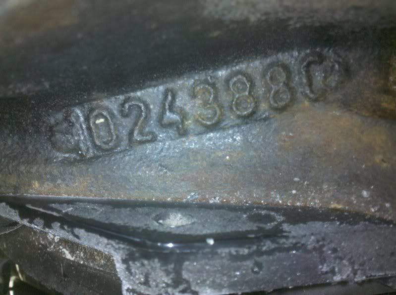

Ok I need some advice. I went looking at the engine and I looked at where everything says the casting number should be (directly behind the port side deck) and instead of a casting number, this is what I found:
On a whim, I looked behind the starboard side and saw this:
What gives?

Ayuh,... No real surprizes there,......
From mortec,...
10243880...350...95-00...2 or 4...Vortec truck, Gen.I crate motors and "ZZ4", roller cam, one piece rear seal

Ok So it's official I have a truck block with a 1 piece rear seal.
So now I gotta get the block out and see what shape everything is in.
Just out of curiosity, A friend of mine suggested I look into possible legal action since technically I purchased a replace marine engine and this engine is for a truck. I'm not very hopeful of getting anything this way but would this be a possibility to at least recoup some of the money spent on the original engine?

Truck blocks are used by GM to make marine engines. GM doesn't cast "MARINE" blocks. They do install marine core plugs and marine cams when Mercruiser, Volvo, and the other marinizers order engines.
