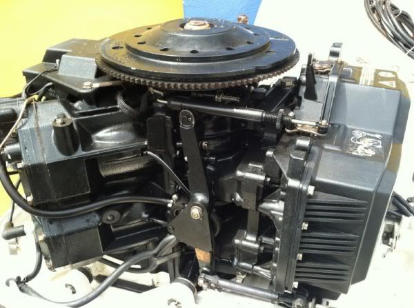

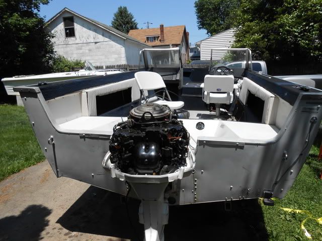

The loopers are much larger blocks. At least the 90 degree models are. All the loopers do have an exhaust passage shape that does bulge out a bit but it is an integral part of the block. On the crossfow the bubble back is bolted to the block. Any chance you could post a couple of pics of the engines?
tincanman
Apr 12, 2012
230
Re: which outboard? '80 or '88 140
only have a couple pics. I will have to get back to the shop to take more pics.
the 1988
the 1980
