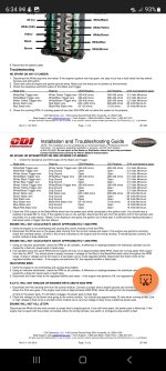

Hey yall,
I am having a problem with no fire on my top two cylinders on the port side of the engine. I tested the ohms using the CDI website for reference. Everything checks out as it should except for the ohms between the red/black stator wire and the blue. CDI says that oem should read between 65 and 130 ohms, but I am seeing 24. I ordered a used stator from Strouds Marine to see if I could have an easy fix but it tests exactly the same at 24 ohms.
Am I missing something or did I receive a bad stator that is messed up in the exact same way my current one is?
If anyone can verify these oem values I would be extremely grateful.

When you say red/black wire do you mean the black/red wire? The wire from the high speed charge coil?
If so, the ohm specification is 24. But more importantly than the wire resistance is the output from the charge coil. What voltages are you seeing?
What are you seeing for the low speed charge coil?

You don't really need a peak voltage reading meter. Measure standard AC voltage and then just multiply that number by 1.414.

I was trying to measure ohms between the two green wires running from the stator to the smaller distribution block above the cdi with the engine off.
On the spec sheet above it's the last highlighted value in yellow.
The two green wires are from the lighting coil to the rectifer/regulator. Nothing whatsoever to do with the ignition coils. Or the ignition system.

As Yam notes, that test is for the ignition coils. All six of them.
