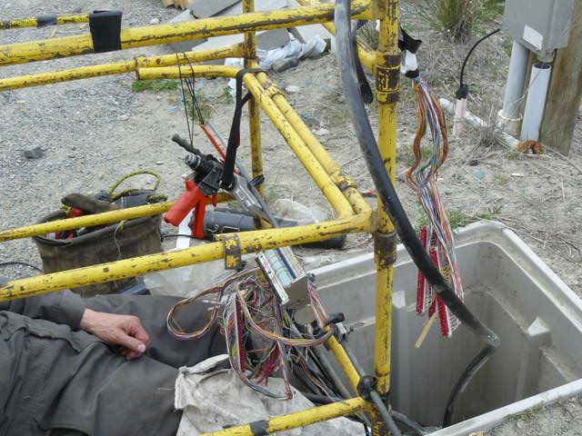

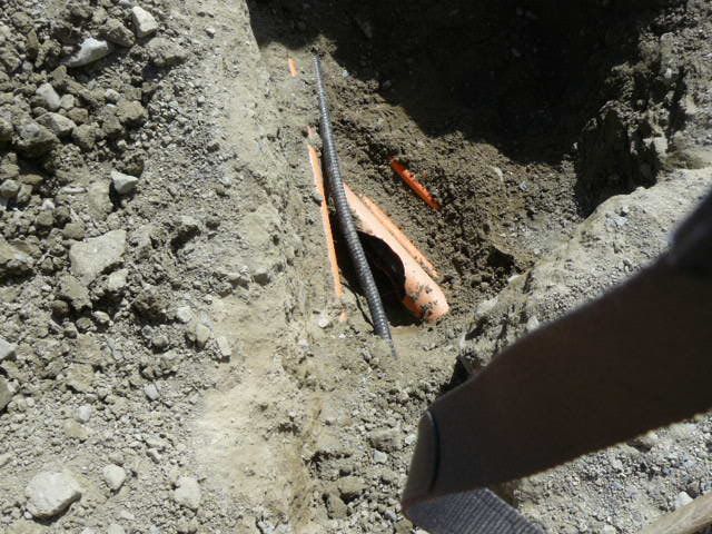

Two days ago we were called in to a customers trailer park because three quarters of the residents phones went dead,
They had been putting in a new trailer up in the origanal park, and had to extend the power.

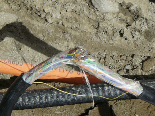

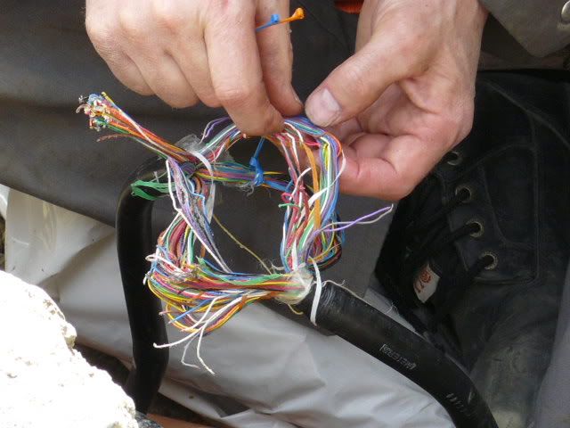

This is what happens when a digging bar goes through conduit and a good portion of a 100 pr cable.
at least I know what I have lined up for work next week.
Well finally we got it done, we are just doing a cut over from the old cable to the new.

Thats a fiber line isnt it?
rbh
Mar 21, 2009
7,939
Re: This is why you call for locates!
nope, good old copper 100pr 24 ga cel.
most people dont realize it but years ago (before fiber and T1 spans) you would go 120.000 feet+ on copper with just neg 47vdc for talk voltage, but you had to put in load coils every 6000 feet so you could understand the guy at the other end.
