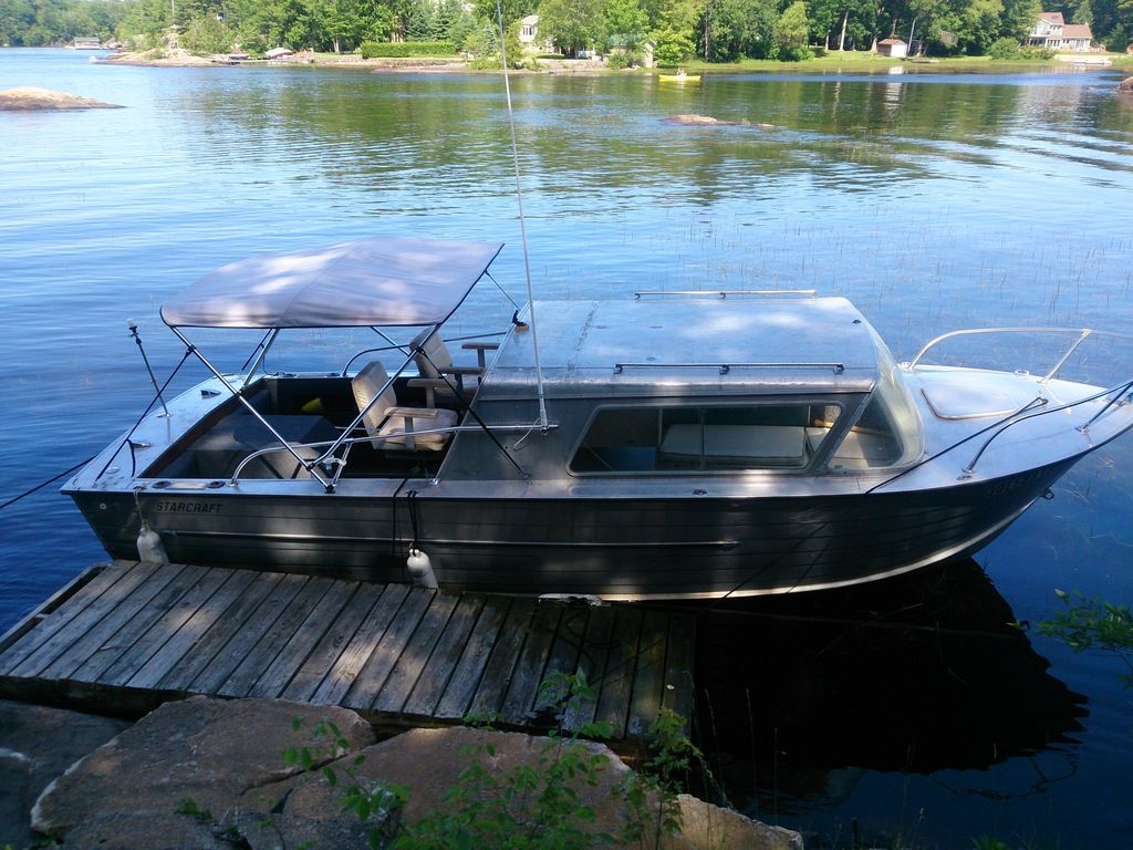

Okay, so winter seems to intend to stay forever.
However on the premise that we will one day see grass again after the 9 feet of snow has melted we would like to have a bimini top for the boat this "summer".
Anyone have some input on what diamentions would be appropriate for our '65 Cheif?
Thinking of something like this.
http://www.ebay.ca/itm/4-Bow-Bimini-Boat-Cover-91-96-600D-UV-8-Waterproof-Top-Boat-Cover-New-/360869106395?pt=Boat_Parts_Accessories_Gear&hash=item54057992db&vxp=mtr&_uhb=1

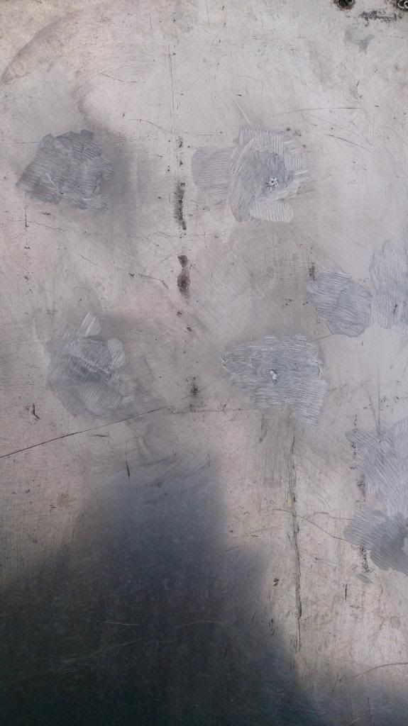

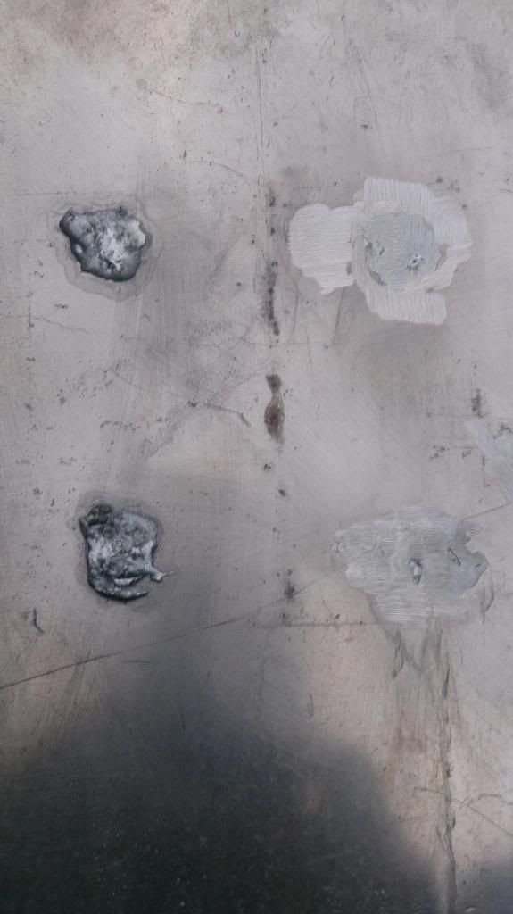

Weathers still been to crappy to do much but found some time today to fill some holes.
The previous owner(s) had a compulsion to drill holes everywhere.
Bought this new product off of fleabay. They are like aluminum brazing rods.
All you need is a propane torch. Goes by many names such as Alumiweld.
Decided to tackle four 3/8 to 7/16 inch holes on each side of the boat.
Worked pretty good and I didnt even set the boat on fire in the process.
Anyone have any techniques to polish out the last remaining grinder marks?

Nice job on filling those holes. I used the same product, after a slight learning curve I was happy. As far as polishing out the marks. Primer will fill em in nicely, otherwise you'll need to take off a lot more material.

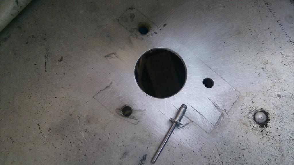

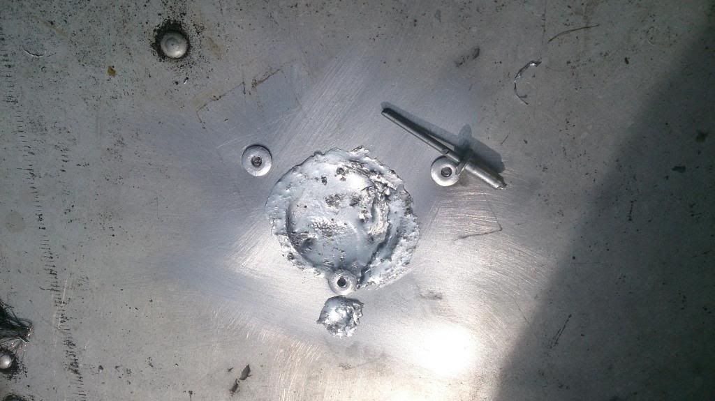

Decided to tackle one of the largest holes drilled into the boat.
This one was about and inch and a half in diameter so I made a support plate out of some aluminum to keep the molten metal from dripping through.
