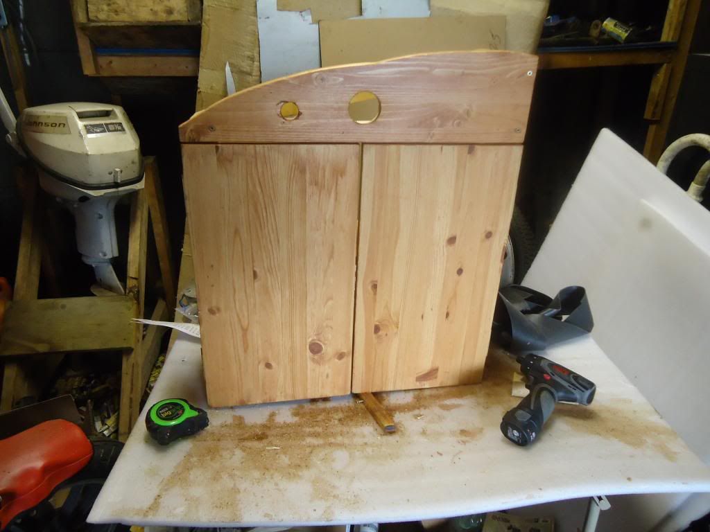

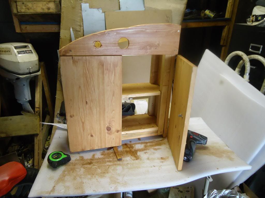

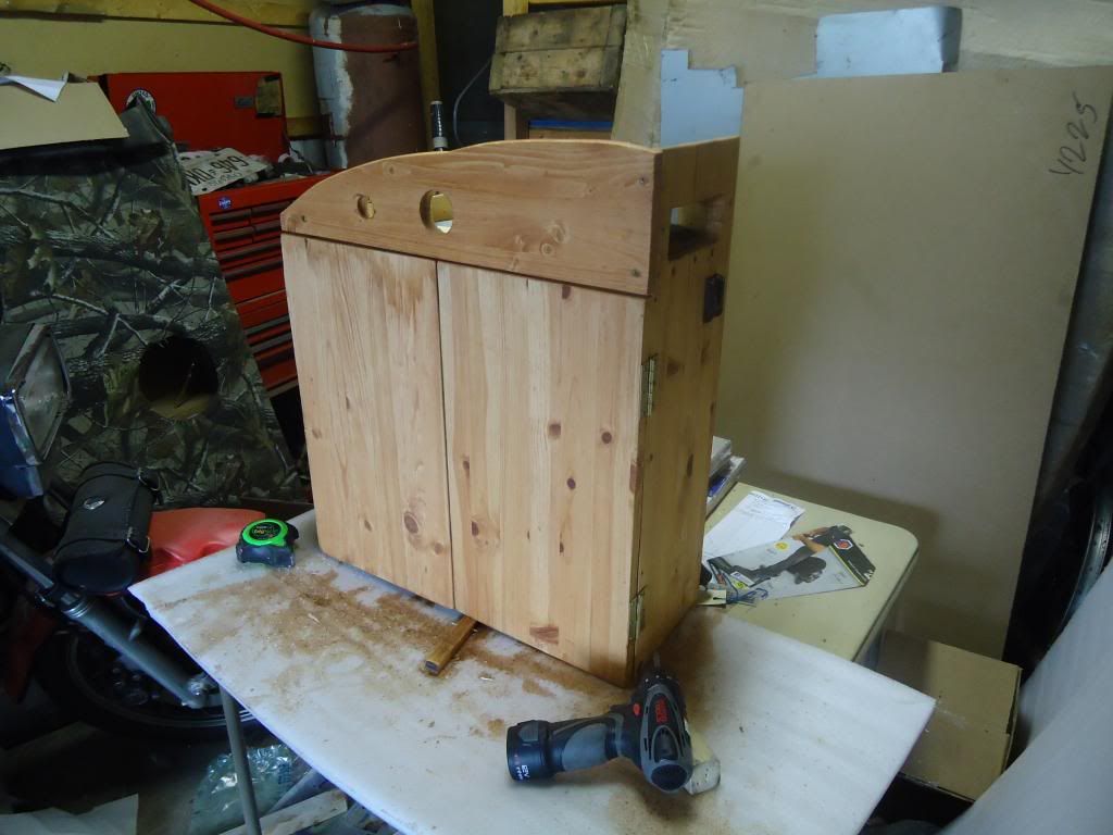

Another small update.
Wanted a cabinet inside the cabin to store wine glasses etc. :wink:
Also will include a few more practicle features.
The right side will house a VHF radio and the top front panel will hold an auxillary voltage guage and a 12V outlet.

Re: 1965 Starcraft Cheiftain
now that there is some purty wood...and nice woodwork! can hardly wait to see the cabin pix when you're done.

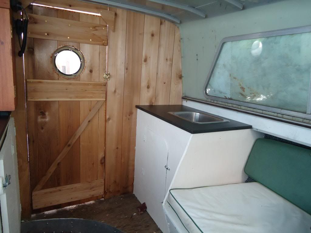

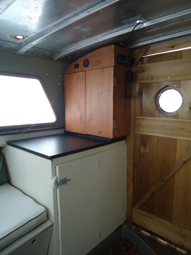

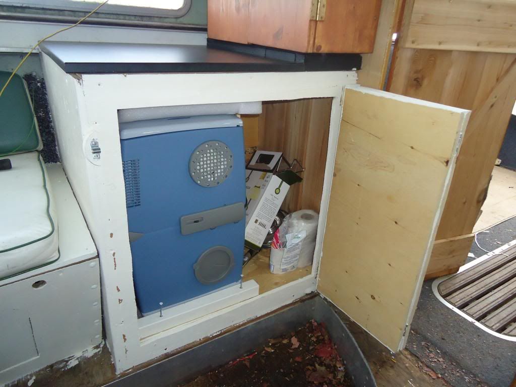

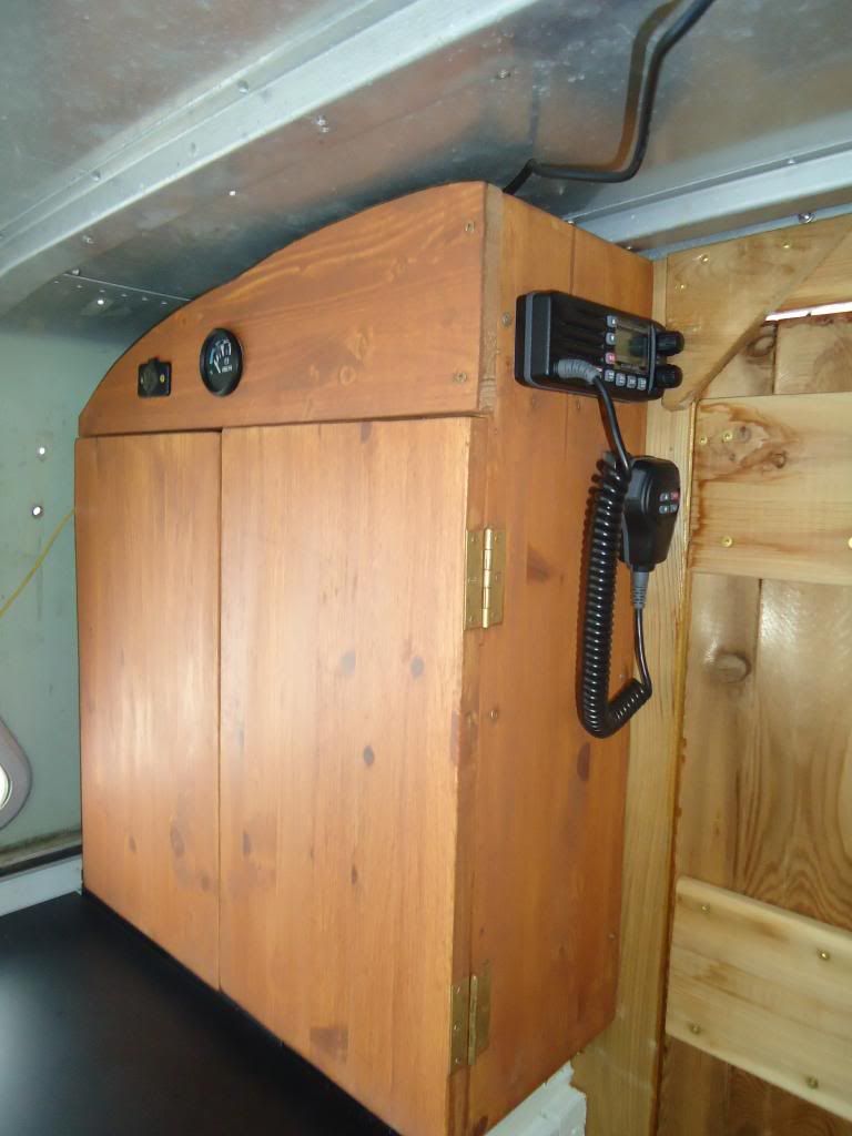

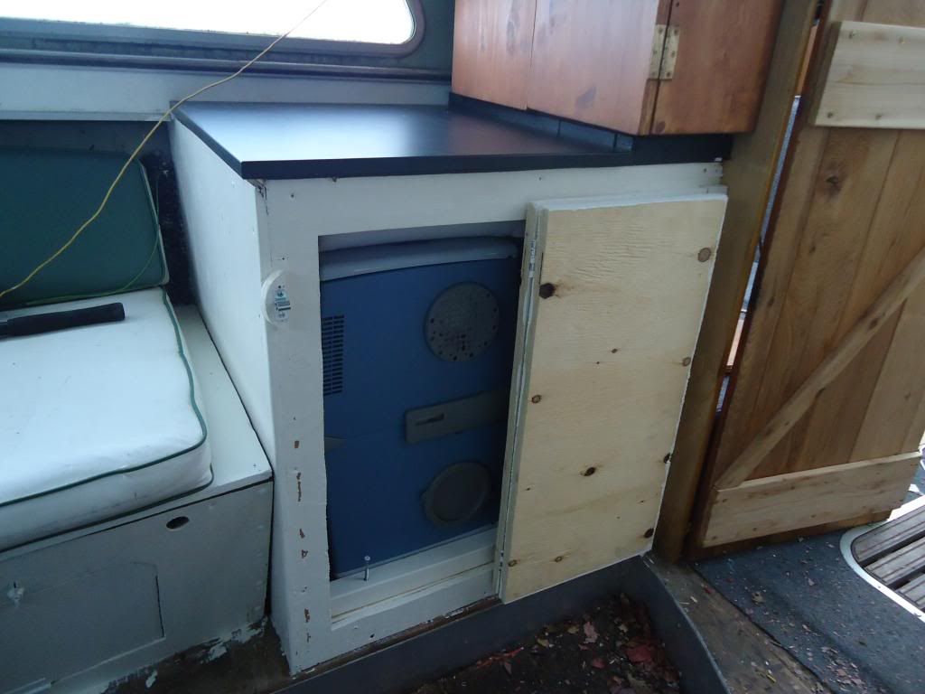

An update on the interior upgrades I have completed for this year.
Still more to do but the priority now is to get her in the water next weekend.
On the starboard side of the boat there was a countertop but the inside of the base was not accesable, just a hollow sealed up box.Now it holds a 12v fridge and some extra storage space beside it.
Cabinet holding VHF radio, 12V outlet and battery voltage meter complete.
The cabin door was originally off to the port side, I moved it to the center. The cabinet on the port side was originally triangular in shape to allow for entry into the cabin due to the offset door. I squared it off to make its capacity larger and reinstalled the original sink.
You have some nice work there, CB. I really like the helm and cabin door move. Heck - I like all of it. :D

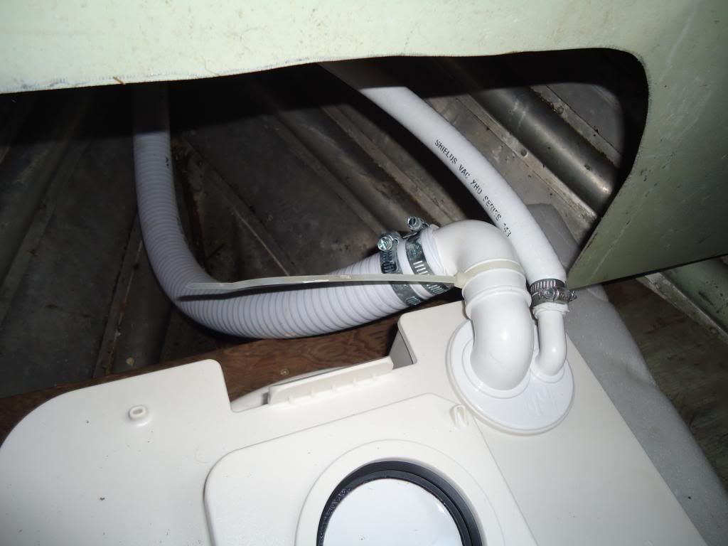

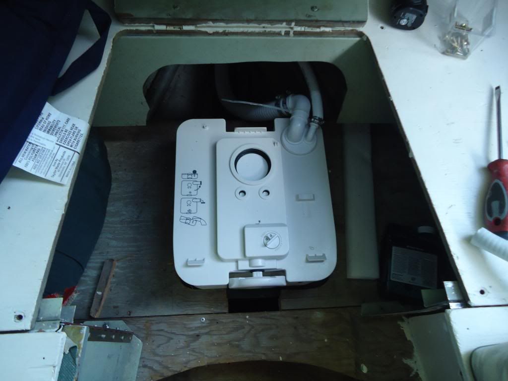

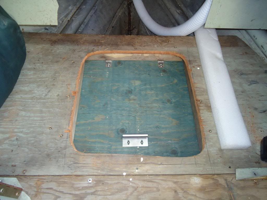

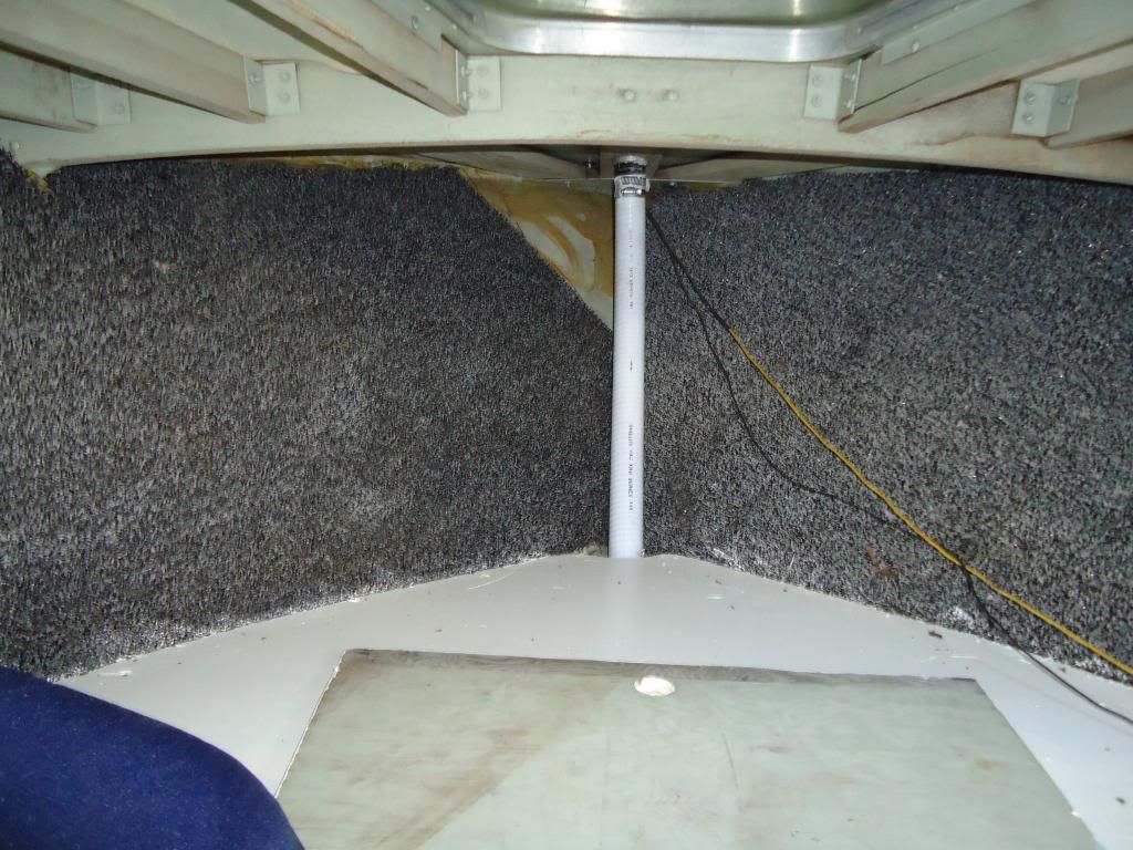

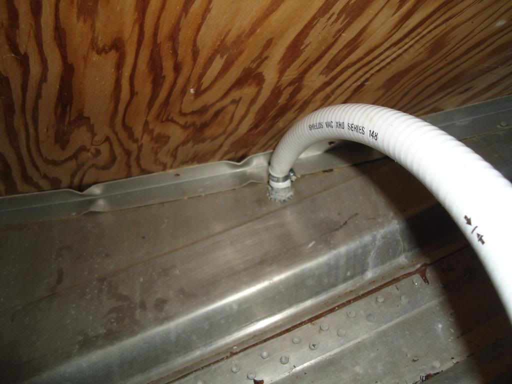

Not sure if anyone is still following this thread but I will continue to post pics of new additions and improvements.
My latest project has been the installation of a toliet to make the wife a little more comfortable on weekend trips.
Bought a toliet from West Marine that had permanent hook up option.
Of course when i placed it where it was to be located it was 1/2" to tall.
So now I had to drop the floor. The following pics show the floor modification and hose hook up.
Hooking up vent hose.
Pump out hose.
Attaching hoses to holding tank.
Install complete!
Looks good so far Craig, w/ the head, you'll greatly extend your range & weekender options.
