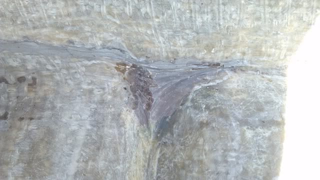

On another note I have a quick question. What's the best way to grind out inside the strakes rght by the transom? It's a very tight fit and I don't want to do some major damage.
Here is all I can really get ground out:

The best way I found to get into those really tight places is with a dremel and a diamond shaped carbide bit...gives you great control...
That would work good. Thanks for the tip!
