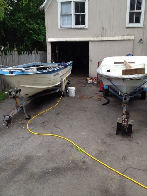

Not able to get boat to boat ramp for leak test, so I'm going to fill her up a bit with water.

Almost done with "fill 'er up test", so far so good....not even a drip. :D

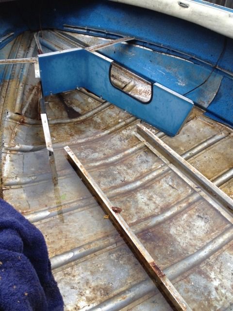

Water test went great.......NO LEAKS AT ALL. :D
Ribs and floor in good shape, no missing rivets or corrosion. I do need to rivet the stringer(to the ribs) in a couple spots.
What kind of rivets and rivet gun do I need? I've never riveted anything before.
